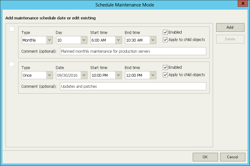

Scheduling Maintenance Mode
You can configure a maintenance schedule for infrastructure objects. When a schedule is set, the maintenance mode will be enabled and disabled automatically according to the schedule.
To configure a maintenance schedule:
  1. Open Veeam ONE Monitor.
For details, see section Accessing Veeam ONE Monitor of the Veeam ONE Monitor User Guide.
  1. At the bottom of the inventory pane, click the necessary view — Infrastructure View, Business View, vCloud Director View, or Data Protection View.
  2. In the inventory pane, right-click an infrastructure object and choose Schedule Maintenance Mode from the shortcut menu.
  3. In the Schedule Maintenance Mode window, configure the maintenance schedule.
  1. Click Add.
  2. In the Type field, specify how often the object must be placed into the maintenance mode (once, monthly, weekly, daily).
  3. In the Day/Date field, specify a day when the maintenance mode must be enabled.
  4. In the Start time and End time fields, specify the start and end time of the maintenance period.
  5. Select the Apply to child objects check box if you want to enable the maintenance mode on the object itself and its child objects.
  6. In the Comment field, provide additional information about the planned maintenance. You can enter up to 512 characters in this field.
  7. Select the Enabled check box to enable the maintenance schedule.
  8. Repeat steps a–g for each schedule entry you want to add.
  1. Click OK.
Scheduled Maintenance Mode
To disable a maintenance schedule:
  1. In the Schedule Maintenance window, clear the Enabled check box next to the necessary schedule entry.
  2. Click OK.
The disabled schedule will remain on the list, but it will not be applied to the object.
To delete a schedule:
  1. In the Schedule Maintenance window, select the check box next to the schedule entry you want to remove.
  2. Click Delete.
  3. Click OK.
