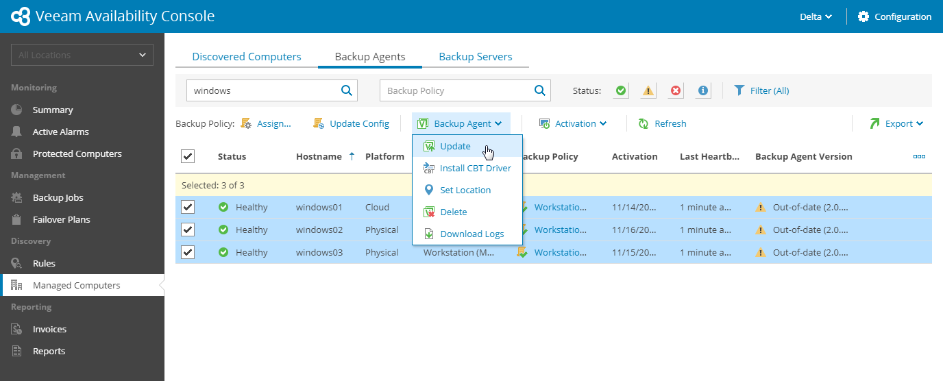

  1. In the menu on the left, under Discovery click Managed Computers.
  2. Open the Backup Agents tab.
  3. Select one or more Veeam backup agents in the list.
  4. At the top of the list, click Backup Agent and choose Update.
After you initiate the update procedure, the value in the Backup Agent Version column will be changed to Updating. You can click the Updating link to track the progress of the update procedure.
  1. Check the value in the Backup Agent Version column.
After the update procedure completes, the value in this column will be set to Up-to-date.
In some cases, after update you might need to perform additional operations. For example, if the setup detects a pending computer reboot, the Backup Agent Version column will display a warning notifying that reboot is required. To complete the update procedure, you can initiate computer reboot in Veeam Availability Console. For details, see Rebooting Remote Computers.

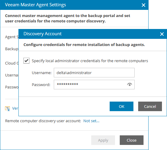

  1. In the master agent settings, specify credentials of an account that will be used to upload the setup file to client computers.
  1. Log on to a computer that hosts the master agent.
  2. In the icon tray, right-click the master agent icon and choose Agent Settings.
  3. In the Veeam Master Agent Settings window, click the Remote computer discovery user account link.
  4. In the Discovery Account window, select the Specify local administrator credentials for remote installation of backup agents check box.
  5. In the Username and Password fields, specify credentials of an account that will be used to upload the Veeam backup agent setup file to client computers.
The account must have local Administrator permissions on all computers in the update scope — that is, computers that run Veeam backup agents that must be updated.
  1. Click OK.
  2. In the Veeam Master Agent Settings window, click Close.
Specify Administrator Credentials
