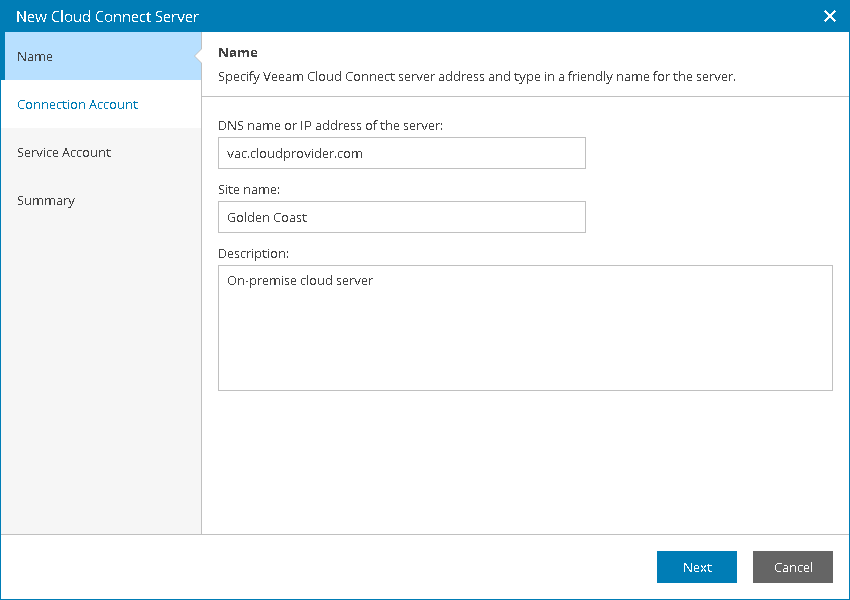

  1. At the Name step of the wizard, specify the following settings:
  1. In the DNS name or IP address of the server field, type FQDN or IP address of the Veeam Cloud Connect server.
  2. In the Site name field, specify the name of the site at which Veeam Cloud Connect server is located.
  3. In the Description field, type server description or comments.
Specify Cloud Server Address

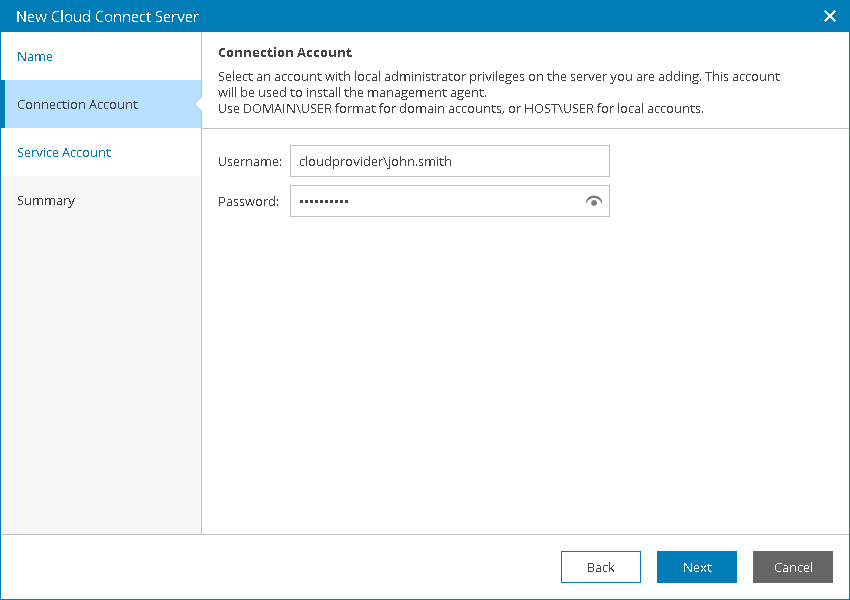

  1. At the Connection Account step of the wizard, specify credentials of a user account with local Administrator privileges on the Veeam Cloud Connect server.
This account will be used to install a Veeam Service Provider Console management agent on the Veeam Cloud Connect server.
The user name must be specified in the DOMAIN\USERNAME format for domain accounts, or HOST\USERNAME format for local accounts.
Specify Connection Account Credentials

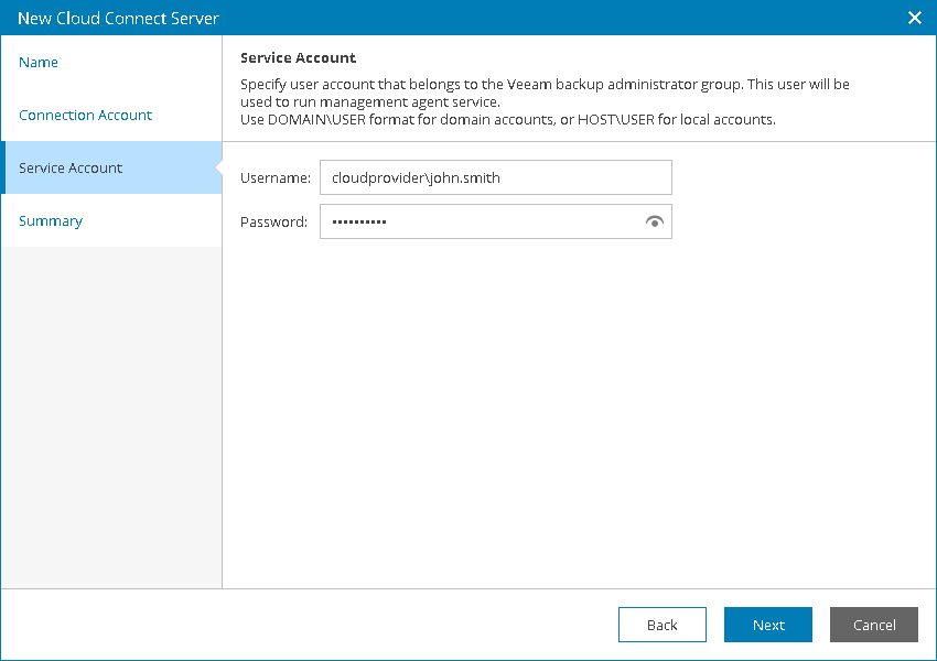

  1. At the Service Account step of the wizard, specify credentials of a user account with Veeam Backup Administrator privileges in Veeam Backup & Replication on the Veeam Cloud Connect server.
This account will be used to run a management agent on the Veeam Cloud Connect server. For details on Veeam Backup & Replication users, roles and privileges, see section Roles and Users of the Veeam Backup & Replication User Guide.
Specify Service Account Credentials

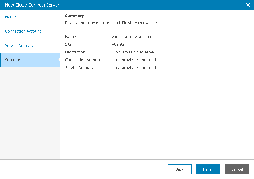

  1. At the Summary step of the wizard, review connection settings and click Finish.
Review Connection Settings
