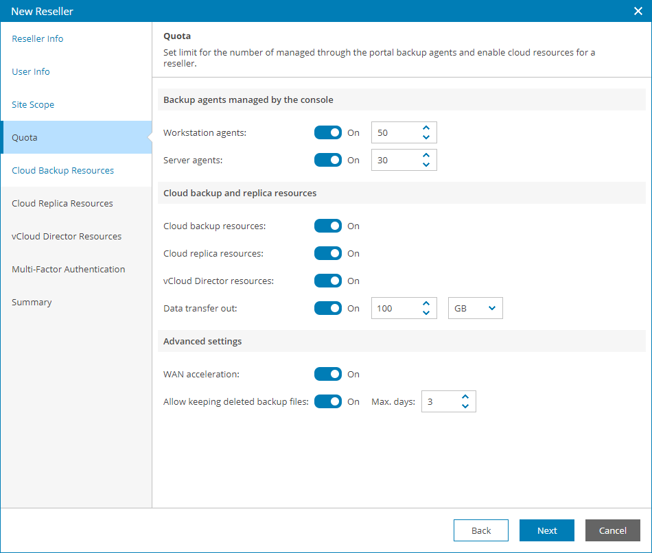

Step 5. Allocate Service Quota
At the Quota step of the wizard, specify services that a reseller can provide to companies:
- To define the number of Veeam backup agents operating in the Workstation mode that a reseller can manage, set the Workstation agents toggle to On and specify the number of managed agents. If you set the toggle to Off, the reseller will be able to manage an unlimited number of Workstation Veeam backup agents.
- To define the number of Veeam backup agents operating in the Server mode that a reseller can manage, set the Server agents toggle to On and specify the number of managed agents. If you set the toggle to Off, the reseller will be able to manage an unlimited number of Server Veeam backup agents.

- To allow reseller companies to use cloud repository resources, set the Cloud backup resources toggle to On.
With this option enabled, the New Reseller wizard will include an additional Cloud Backup Resources step.
- To allow reseller companies to use cloud replication resources, set the Cloud replica resources toggle to On.
With this option enabled, the New Reseller wizard will include an additional Cloud Replica Resources step.
- To allow reseller companies to use VMware vCloud Director resources, set the vCloud Director resources toggle to On.
With this option enabled, the New Reseller wizard will include an additional vCloud Director Resources step.
- To limit the amount of data that reseller companies are allowed to download from the cloud repository during a billing period, set the Data transfer out toggle to On and specify the allowed amount of data.
The Data transfer out quota is a soft quota and puts no physical restriction on the cloud repository. When the reseller reaches the specified quota, Veeam Service Provider Console triggers the Reseller data download quota alarm. You can customize this alarm in accordance with your requirements. For details, see Modifying Alarm Settings.
Reseller users will see this quota in the Data Transfer Out widget of the Cloud Backup Quota dashboard. For details, see section Cloud Backup Quota of the Guide for Resellers.
- To allow reseller companies to use WAN Acceleration for backup and replication jobs that write data to the cloud, set the WAN Acceleration toggle to On.
- To enable additional protection for company backup files stored on cloud repositories, set the Allow keeping deleted backup files toggle to On and specify how long deleted backup files must be kept in the recycle bin on the Veeam Cloud Connect server.
