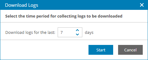

    3. In the Download Logs window, specify a number of days for which job statistics and logs must be collected.
    Download Logs
    1. Click Start.
    2. Wait until Veeam Service Provider Console collects session and log data.
