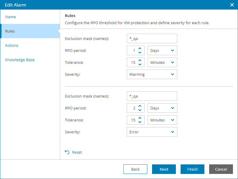

    Step 2. Specify Alarm Rules
    At the Rules step of the wizard, specify conditions according to which the alarm must be triggered. Options available for alarm rules vary for different alarms. Depending on the alarm type, you may need to modify alarm thresholds, alarm tolerance, alarm severity and so on.
    To reset alarm rules to default settings, click Reset.
    Customize Alarm Rules
    Tip:
    You can use the following characters for masks:
    • (*) — a substitution for one or more characters in the object name or path. Can be used for any sequence of characters (including no characters).
    • (?) — a substitution of one character in the object name or path.
    • (;) — a separator between multiple masks.

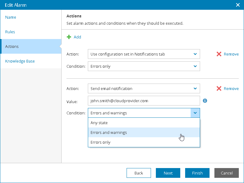

    Sending Alarm Notifications by Email
    You can add an alarm action that will send an email notification when a new alarm is triggered, or when the alarm status changes:
    1. At the top left corner of the wizard, click Add.
    2. In the Action field, choose Send email notification.
    3. In the Value field, type an email address at which a notification must be sent.
    You can specify multiple email addresses separated with commas (,) or semicolons.
    Tip:
    To send a notification to multiple users, you can use the following variables:
    • %Portal Admins% — to send a notification to users with the Portal Administrator and Site Administrator roles;
    • %Operators% — to send a notification to users with the Portal Operator role;
    • %Readonly Users% — to send a notification to users with the Read-only User role;
    • %Company Owner% — to send a notification to company users with the Company Owner role;
    • %Company Admins% — to send a notification to company users with the Company Administrator and Company Owner roles;
    • %Location Admins% — to send a notification to company users with the Location Administrator role;
    • %Reseller% — to send a notification to reseller users with the Service Provider Global Administrator role;
    • %Reseller Admins% — to send a notification to reseller users with the Service Provider Administrator role;
    • %Reseller Operators% — to send a notification to reseller users with the Service Provider Operator role;
    • %Subtenants% — to send a notification to company users with the Subtenant role.
    Veeam Service Provider Console sends an alarm notification only to owners of an object for which an alarm is triggered.
    To receive a notification, the user must configure an email address in the user profile. For details, see Filling User Profile.
    1. In the Condition field, choose an alarm state that must trigger the response action:
    • Any state — select this option if a notification must be sent every time when the alarm status changes to Error, Warning or Info, or when a new alarm with one of these statuses is triggered.
    • Errors and warnings — select this option if a notification must be sent every time when the alarm status changes to Error or Warning, or when a new alarm with one of these statuses is triggered.
    • Errors only — select this option if a notification must be sent every time when the alarm status changes to Error, or when a new alarm with this status is triggered.
    Customize Alarm Response Actions

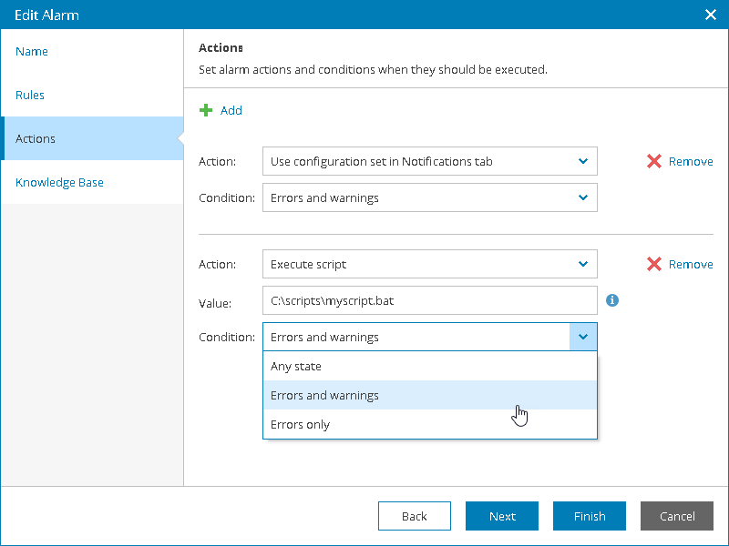

    Running Custom Script
    You can add an alarm action that will run a custom script when a new alarm is triggered, or when the alarm status changes. This can be a BAT, CMD, EXE or PS1 script.
    By running a script, you can automate routine tasks that are normally performed when specific alarms fire. For example, if a critical system is affected, you may need to immediately open a ticket with the in-house support or perform actions that will eliminate the problem.
    2. In the Action field, choose Execute script.
    3. In the Value field, type a path to the script file.
    The script must reside on the machine where Veeam Service Provider Console is installed. If you used a distributed deployment scenario, place the script on the machine where the Veeam Service Provider Console Server component runs.
    You can also provide the following variables separated by spaces: %AlarmName%, %NewState%, %Time%, %ObjectName%.
    • Any state — select this option if the script must run every time when the alarm status changes to Error, Warning or Info, or when a new alarm with one of these statuses is triggered.
    • Errors and warnings — select this option if the script must run every time when the alarm status changes to Error or Warning, or when a new alarm with one of these statuses is triggered.
    • Errors only — select this option if the script must run every time when the alarm status changes to Error, or when a new alarm with this status is triggered.
