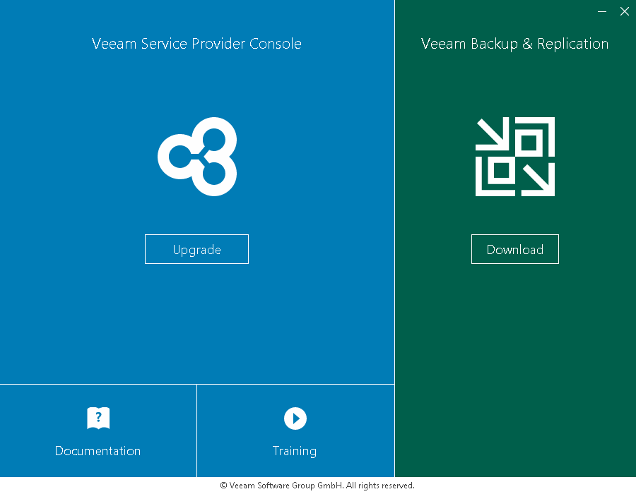

- Run the Setup.exe file from the image to launch the setup splash screen.
- On the splash screen, click the Upgrade tile to launch the Veeam Service Provider Console Setup wizard.

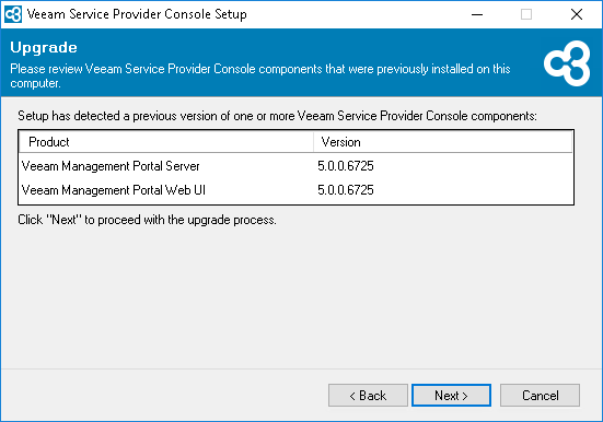

- At the Upgrade step of the wizard, review the components to upgrade.

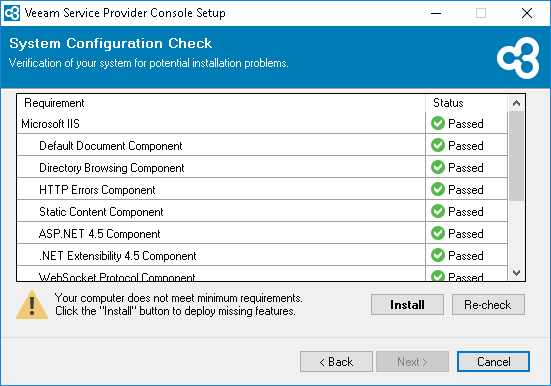

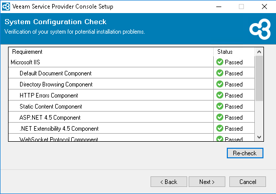

- At the System Configuration Check step of the wizard, check what prerequisite software is missing.
Before proceeding with the upgrade, the installer will perform system configuration check to determine if all prerequisite software is available on the machine. To learn what software is required for Veeam Service Provider Console, see System Requirements.
If some of the required software components are missing, the setup wizard will offer you to install the missing software components and enable missing features automatically. To install the missing software components and enable missing features automatically, click the Install button.
You can cancel automatic software installation. In this case, you will need to install the missing software components and enable missing features manually (otherwise, you will not be able to proceed to the next step of the setup wizard). After you install and enable all required software components, click Re-check to repeat the system configuration check.

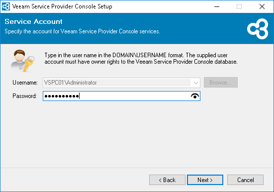

- At the Service Account step of the wizard, specify password for the account under which Veeam Service Provider Console services run.

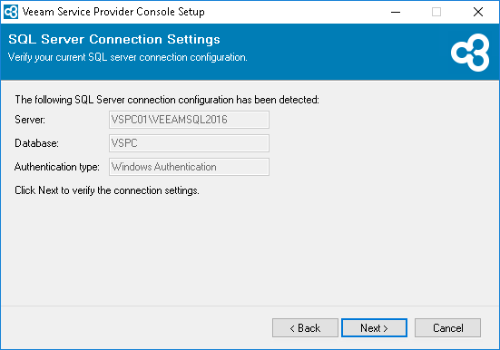

- At the SQL Server Connection Settings step of the wizard, check settings of a connection to Microsoft SQL Server instance and Veeam Service Provider Console database.
