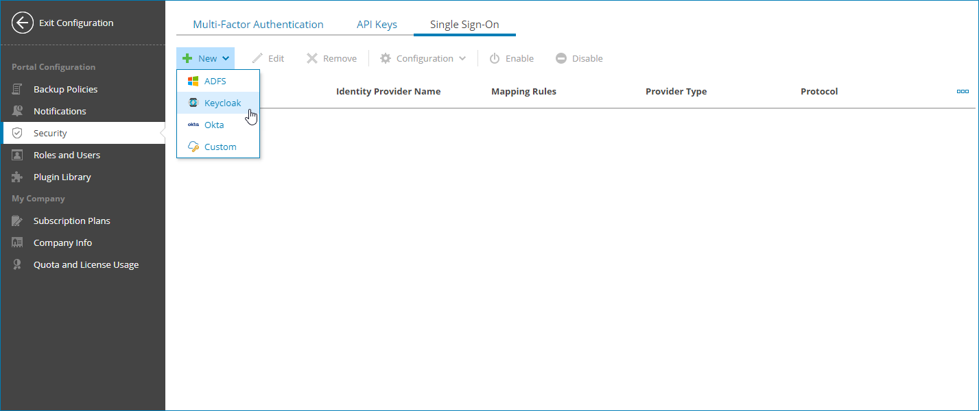

- On the Single Sign-On tab, click New and select an identity provider service from the drop-down list.
The identity provider configuration wizard will open.

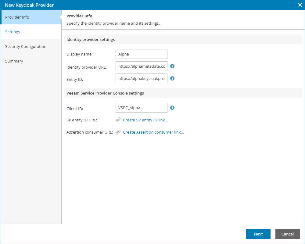

- In the Display name field, specify the IdP name that will be displayed in the IdP list on the Single Sing-On tab.
- In the Identity provider URL field, specify URL of the page containing metadata that is required by IdP.
- [For Okta, Keycloak and Custom identity providers] In the Entity ID field, specify the unique identifier that an IdP will use to identify SP.
- In the Client ID field, specify the name of the client created for Veeam Service Provider Console on the IdP side.
Note that the name must be at least 5 and not more than 32 characters long and must not contain special characters.
- [For Okta, Keycloak and Custom identity providers] Click SP entity ID link to generate entity ID URL based on the portal web address and the Client ID value.
If you apply changes to Client ID value after link generation, click New link.
- [For Okta, Keycloak and Custom identity providers] Click Create Assertion consumer link to generate assertion consumer service URL based on the portal web address and the Client ID value.

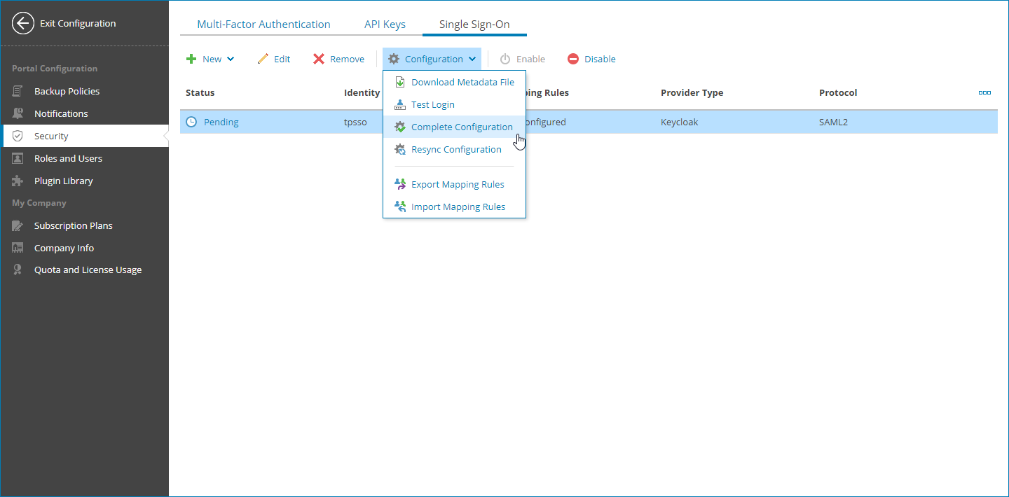

- Select the new identity provider in the list.
- From the Configuration drop-down list, select Complete Configuration.
If you have mapping rules configured, you can also select Test Login. It allows you to perform a trial authorization. If it is successful, the identity provider configuration is completed automatically.

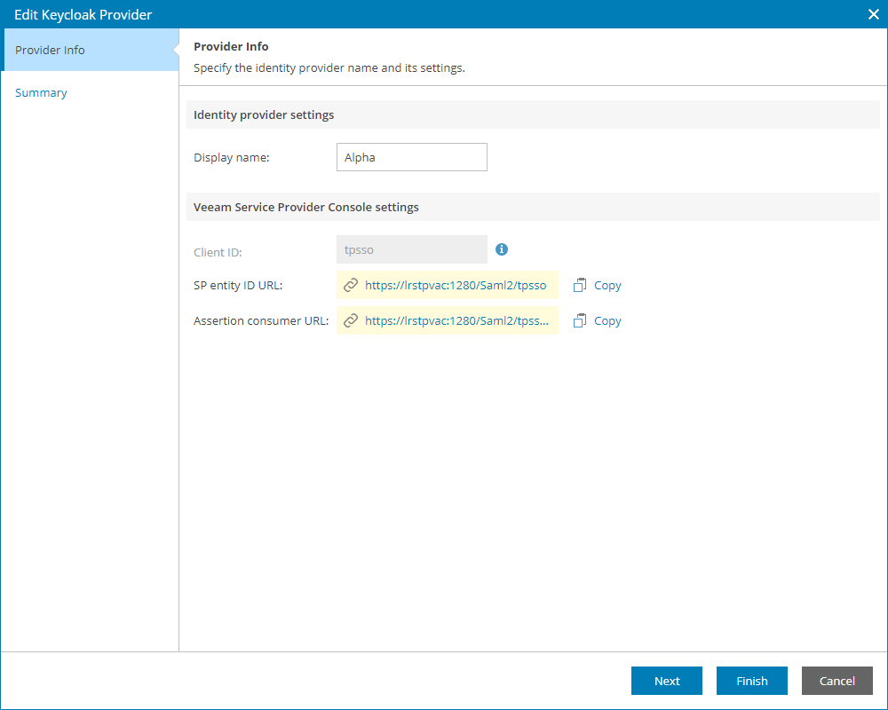

- At the top of the list, click Edit.
Alternatively, you can right-click the necessary identity provider and choose Edit.
The Edit Identity Provider wizard will open.
- In the Display name field, specify a new IdP display name.
- Click Finish.

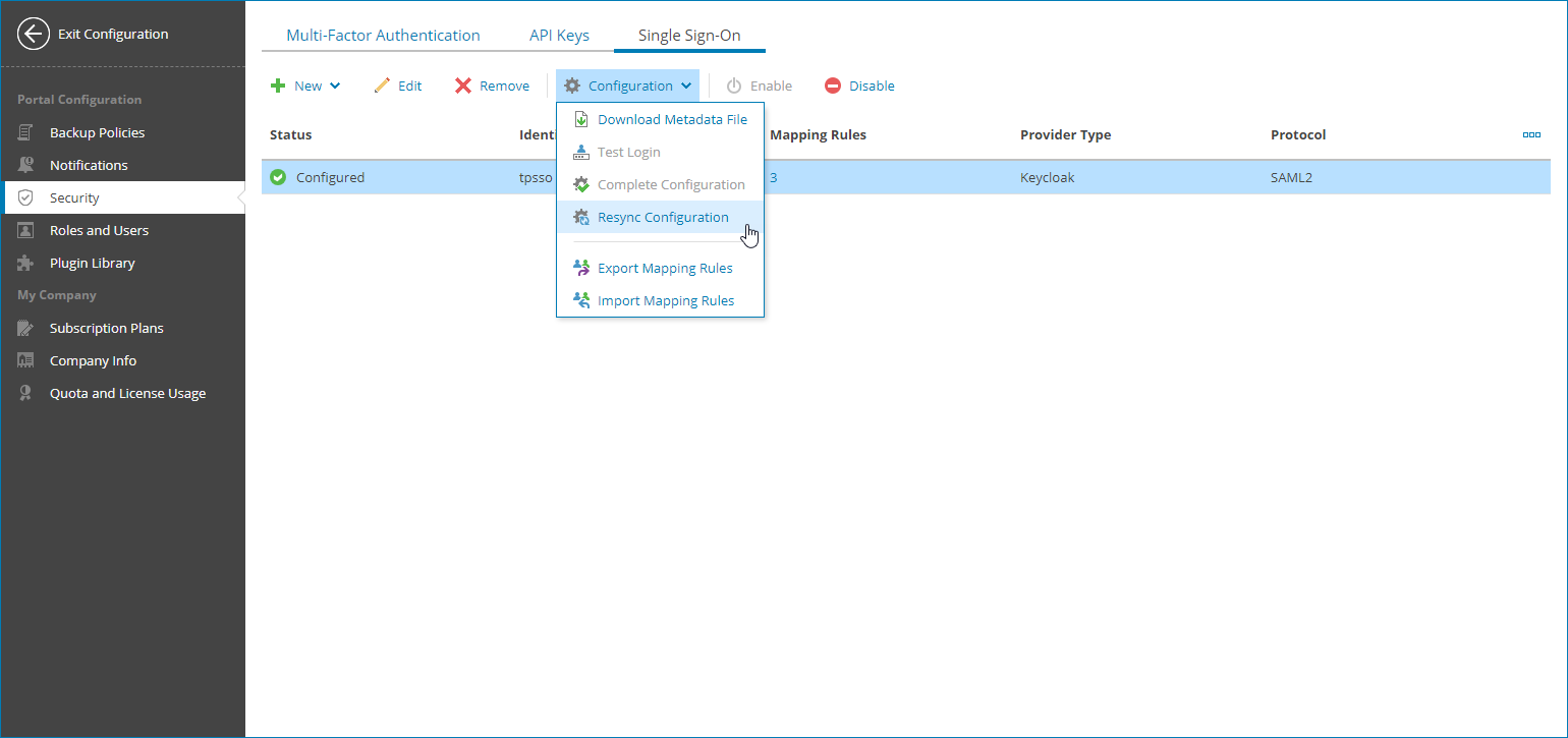

- From the Configuration drop-down list, select Resync Configuration.
Alternatively, you can right-click the necessary identity provider, choose Configuration and select Resync Configuration.

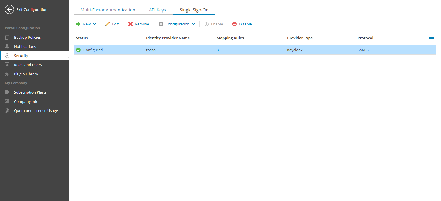

- At the top right corner of the Veeam Service Provider Console window, click Configuration.
- In the configuration menu on the left, click Security.
- Open the Single Sign-On tab.
Each identity provider in the list is described with the following set of properties:
- Status — status of the IdP.
- Identity Provider Name — display name of the IdP.
- Mapping Rules — mapping rules configured for the IdP.
- Provider Type — name of the IdP service.
- Protocol — authentication protocol.
