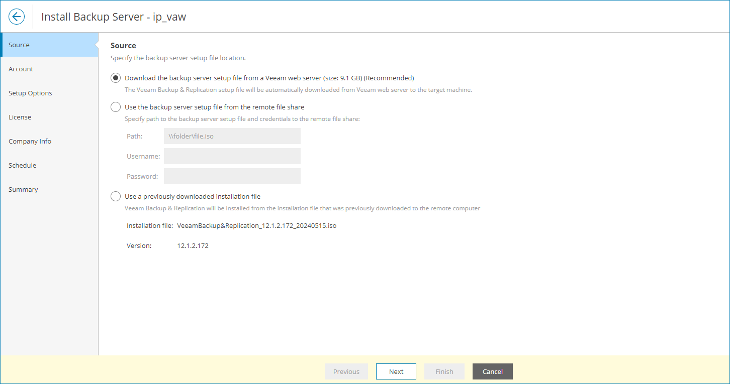

- At the Source step of the wizard, specify location of the Veeam Backup & Replication distribution:
- To use a latest distribution from Veeam Installation Server (over the Internet), select the Download the backup server setup file from a Veeam web server option.
- To use a distribution stored on a remote file share, select the Use the backup server setup file from the remote file share option and specify remote file share location and credentials of an account that Veeam Service Provider Console will use to connect to the file share.
- If you have previously downloaded an installation file to the remote computer in Veeam Service Provider Console, select the Use a previously downloaded installation file option. Veeam Service Provider Console will locate the downloaded installation file automatically.
For details on how to download the installation file in Veeam Service Provider Console, see Downloading Setup File.

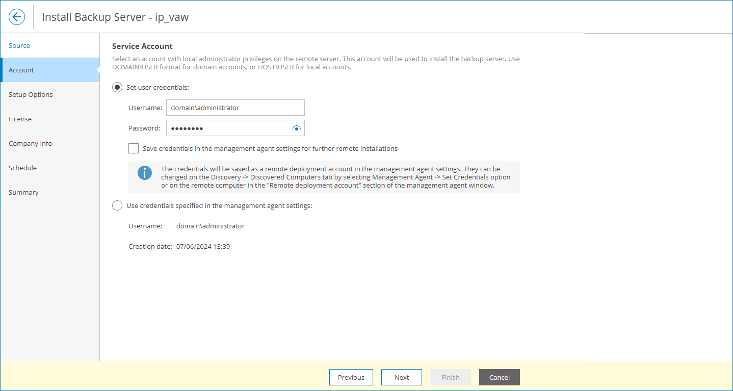

- At the Account step of the wizard, specify service account credentials:
- Select the Set user credentials option to set the user name and password.
The account must have local administrator permissions on the remote computer.
To store the user name and password as remote deployment account credentials in the management agent, select the Save credentials in the management agent settings for further remote installations check box. This will allow you to use these credentials to upgrade the Veeam Backup & Replication server in Veeam Service Provider Console.
If you have previously saved credentials in the management agent, you must confirm overwriting the saved credentials.
You can also set or update service account credentials in Veeam Service Provider Console. For details, see Modifying Management Agent Credentials.
- Select the Use credentials specified in the management agent settings option to use the credentials saved in the management agent settings.

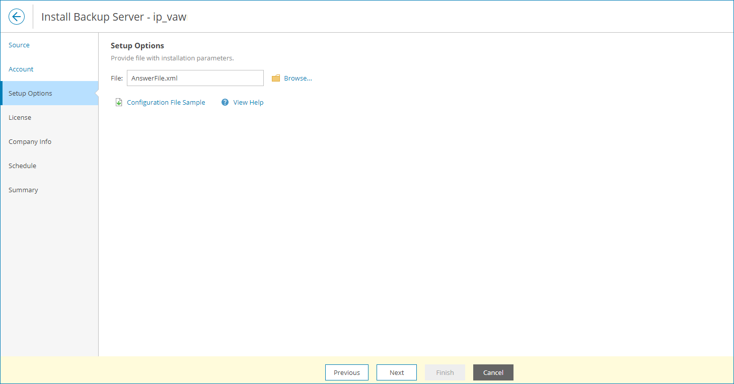

- At the Setup Options step of the wizard, specify path to an XML file with installation parameters.
To create a configuration file, click Configuration File Sample to download the file template and fill in the necessary configuration parameters. For details on configuration parameters, see Configuration Parameters.

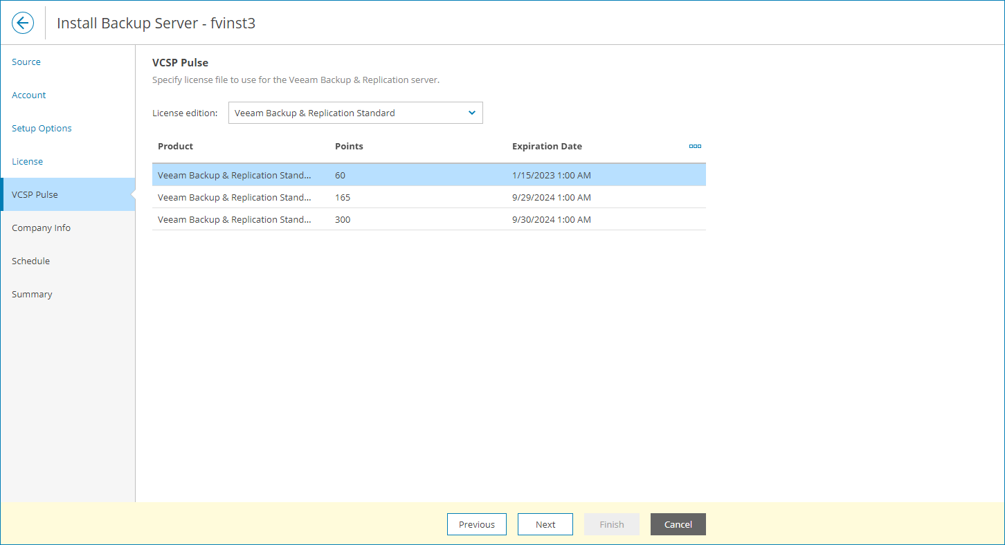

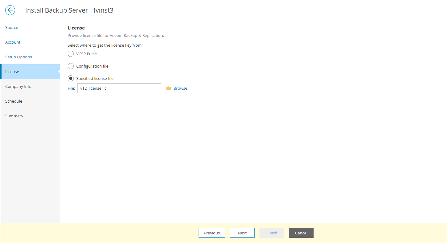

- At the License step of the wizard, do one of the following:
- To install license key configured in VCSP Pulse, select VCSP Pulse.
This option is available only if you have configured integration with VCSP Pulse. For details, see Integration with VCSP Pulse.
If this option is selected, the VCSP Pulse step will become available in the wizard.
- To install license provided in configuration file, select Configuration file.
- To upload license file from your computer, select Specified license file, click Browse and specify a path to the license file.
- [If you have selected VCSP Pulse at step 9] At the VCSP Pulse step of the wizard, select the necessary license key in the list.
It is not recommended to install one VCSP Pulse license in multiple products. If you have selected a license key that is already installed in another product and your service provider has enabled license management for your company, Veeam Service Provider Console will ask you to copy the license key. If you do not want to copy the license key, you can download the license file from VCSP Pulse and install it manually. Note that in license usage report Veeam Service Provider Console will add up points usage for all servers with the same license ID.

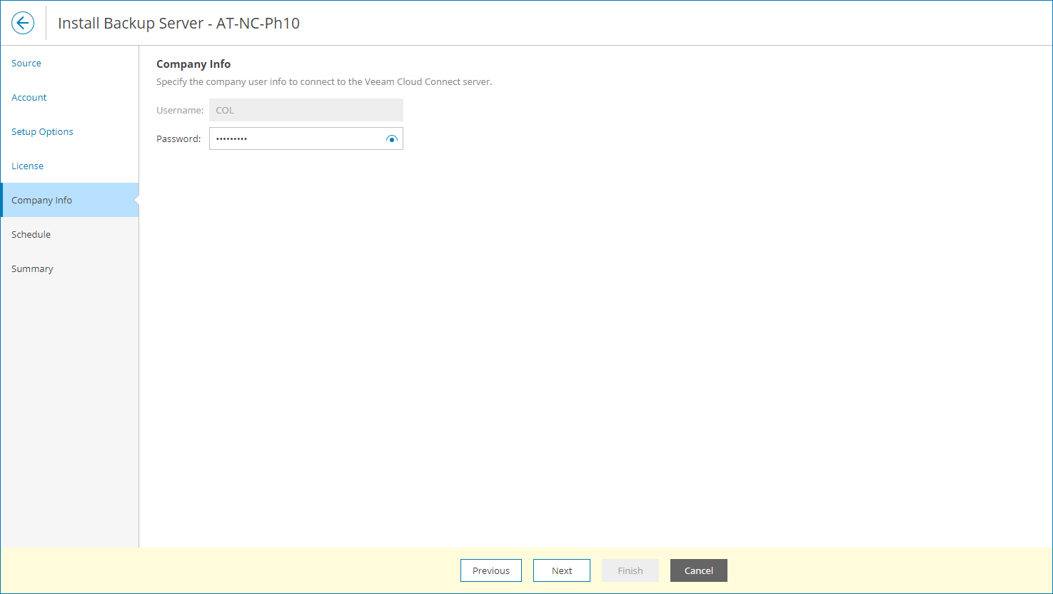

- At the Company Info step of the wizard, specify password for the Veeam Cloud Connect tenant account (for Native Veeam Cloud Connect tenant accounts) or credentials for the VMware Cloud Director organization administrator account (for VMware Cloud Director tenant accounts).

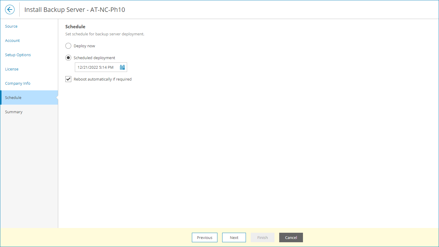

- At the Schedule step of the wizard, specify when you want to install Veeam Backup & Replication:
- To install Veeam Backup & Replication immediately, select Deploy now.
- To postpone installation, select Scheduled deployment and specify date and time when Veeam Backup & Replication will be installed.
You will be able to reschedule or cancel the installation using the link in the Scheduled Deployment column on the Discovered Computers tab.
If you want to reboot remote computers automatically during Veeam Backup & Replication installation, select the Reboot automatically if required check box. If you do not select the check box, you may need to reboot the backup server manually to complete installation. For details, see Rebooting Remote Computers.

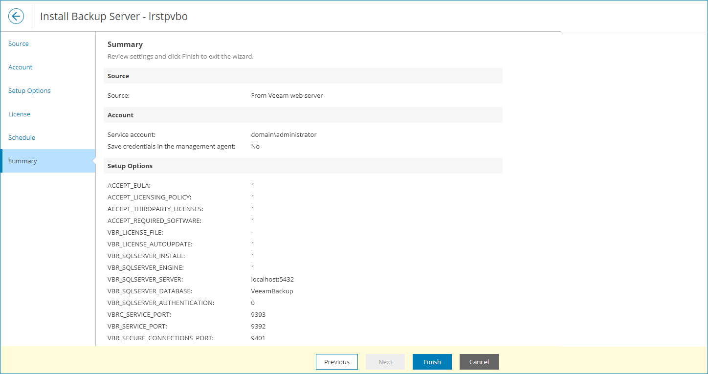

- At the Summary step of the wizard, review installation settings and click Finish.

The configuration file contains the following parameters:
- ACCEPT_EULA — specify "1" to accept Veeam license agreement.
- ACCEPT_LICENSING_POLICY — specify "1" to accept Veeam licensing policy.
- ACCEPT_THIRDPARTY_LICENSES — specify "1" to accept the license agreement for 3rd party components that Veeam incorporates.
- ACCEPT_REQUIRED_SOFTWARE — specify "1" to accept all required software license agreements.
- VBR_LICENSE_FILE — path to the license file on the machine where you want to install Veeam Backup & Replication. If you want to install VCSP Pulse license or provide the license file manually, leave this parameter empty.
- VBR_LICENSE_AUTOUPDATE — specify "1" to enable automatic license update and usage reporting. Specify "0" if you want to update the license manually. For NFR licenses, specify "1". For licenses without ID information, specify "0".
- VBR_SERVICE_USER — user account under which the Veeam Backup Service will run. If you do not specify this parameter, the service will run under the LocalSystem account.
- VBR_SERVICE_PASSWORD — password for the account under which the Veeam Backup Service will run.
- VBR_SQLSERVER_INSTALL — specify "0" to use an existing SQL server instance or specify "1" to create a new SQL server instance.
- VBR_ENTRAID_DATABASE_INSTALL — specify "1" if you want to install a PostgreSQL database for Microsoft Entra ID. Specify "0" if you do not want to install the database.
- VBR_SQLSERVER_ENGINE — specify "0" to use PostgreSQL engine or specify "1" to use Microsoft SQL engine. Note that if you want to create a new SQL server instance, you can only choose the PostgreSQL engine.
- VBR_SQLSERVER_SERVER — SQL server and instance (for Microsoft SQL) or SQL server an port (for PostgreSQL) where the configuration database will be deployed. Note that if you want to create a new SQL instance, you can only connect to a local host.
- VBR_SQLSERVER_DATABASE — configuration database name.
- VBR_SQLSERVER_AUTHENTICATION — specifies authentication mode to connect to the SQL Server where the Veeam Backup & Replication configuration database is deployed. Specify "1" to use the SQL Server authentication mode or specify "0" to use the Microsoft Windows authentication mode.
- VBR_SQLSERVER_USERNAME — LoginID to connect to the SQL Server in the SQL Server authentication mode.
- VBR_SQLSERVER_PASSWORD — password to connect to the SQL Server in the SQL Server authentication mode.
- VBRC_SERVICE_PORT — TCP port that will be used by the Veeam Guest Catalog Service.
- VBR_SERVICE_PORT — TCP port that will be used by the Veeam Backup Service.
- VBR_SECURE_CONNECTIONS_PORT — port used for communication between the mount server and the backup server.
- VBR_RESTSERVICE_PORT — port used for communication with REST API service.
- INSTALLDIR — path to the directory where Veeam Backup & Replication will be installed.
- VM_CATALOGPATH — path to the catalog folder where index files will be stored.
- VBR_IRCACHE — path to the folder where the instant recovery cache will be stored.
- VBR_CHECK_UPDATES — specify "1" to automatically check for new product versions and updates. Specify "0" if you do not want Veeam Backup & Replication to check for updates automatically.
- AHV_INSTALL — specify "1" if you want to install Nutanix AHV Plug-in for Veeam Backup & Replication. Specify "0" if you do not want to install the plugin.
- KVM_INSTALL — specify "1" if you want to install oVirt KVM Plug-in for Veeam Backup & Replication. Specify "0" if you do not want to install the plugin.
- PVE_INSTALL — specify "1" if you want to install Proxmox VE Plug-in for Veeam Backup & Replication. Specify "0" if you do not want to install the plugin.
- AWS_INSTALL — specify "1" if you want to install AWS Plug-in for Veeam Backup & Replication. Specify "0" if you do not want to install the plugin.
- AZURE_INSTALL — specify "1" if you want to install Microsoft Azure Plug-in for Veeam Backup & Replication. Specify "0" if you do not want to install the plugin.
- GCP_INSTALL — specify "1" if you want to install Google Cloud Plug-in for Veeam Backup & Replication. Specify "0" if you do not want to install the plugin.
- KASTEN_INSTALL — specify "1" if you want to install Kasten Plug-in for Veeam Backup & Replication. Specify "0" if you do not want to install the plugin.
Note that you must specify "1" in ACCEPT_EULA, ACCEPT_LICENSING_POLICY, ACCEPT_THIRDPARTY_LICENSES and ACCEPT_REQUIRED_SOFTWARE parameters to proceed with the installation.
