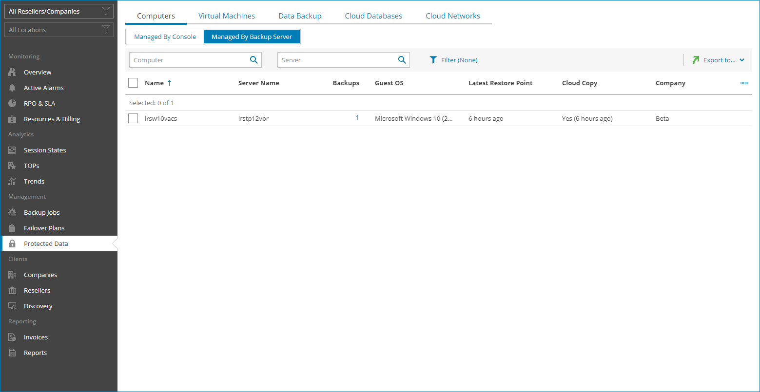

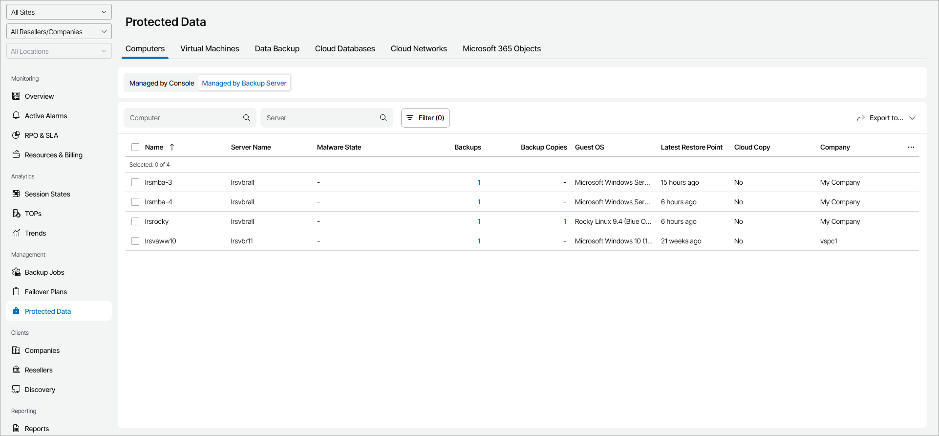

To view and export details of Veeam backup agents protected by Veeam Backup & Replication:
  1. Log in to Veeam Service Provider Console as a Portal Administrator, Site Administrator, Portal Operator or Read-only User.
  1. In the menu on the left, click Protected Data.
  2. Open the Computers tab and navigate to Managed by Backup Server.
Veeam Service Provider Console will display a list of all managed Veeam backup agents.
  1. To narrow down the list of backup jobs, you can apply the following filters:
  • Computer — search the list of computers by the name.
  • Server — search the list of computers by the name of a backup server that manages Veeam backup agent.
  • Operation mode — limit the list of computers by Veeam backup agent operation mode (Server, Workstation).
  • Cloud copy — limit the list of computers by cloud copy existence (Yes, No).
  • Malware state — limit the list of computers by restore point infection status (Clean, Infected, Suspicios, Unknown).
  • Backup type — limit the list of computers by backup operation type (Entire computer, Volume-level, File-level).
  • Guest OS — limit the list of protected computers by guest OS (Windows, Linux, macOS).
  • Site/Reseller/Company/Location — limit the list of jobs by Veeam Cloud Connect site, reseller, company and location to which jobs belong. To limit the list of jobs by site, reseller, company and location, use filters at the top left corner of the Veeam Service Provider Console window.
  1. To export protected computer details, click Export to and choose a format of the exported data:
View Protected Computer Details
Each protected computer in the list is described with a set of properties. By default, some properties in the list are hidden. To display additional properties, click the ellipsis on the right of the list header and choose job properties that must be displayed.
