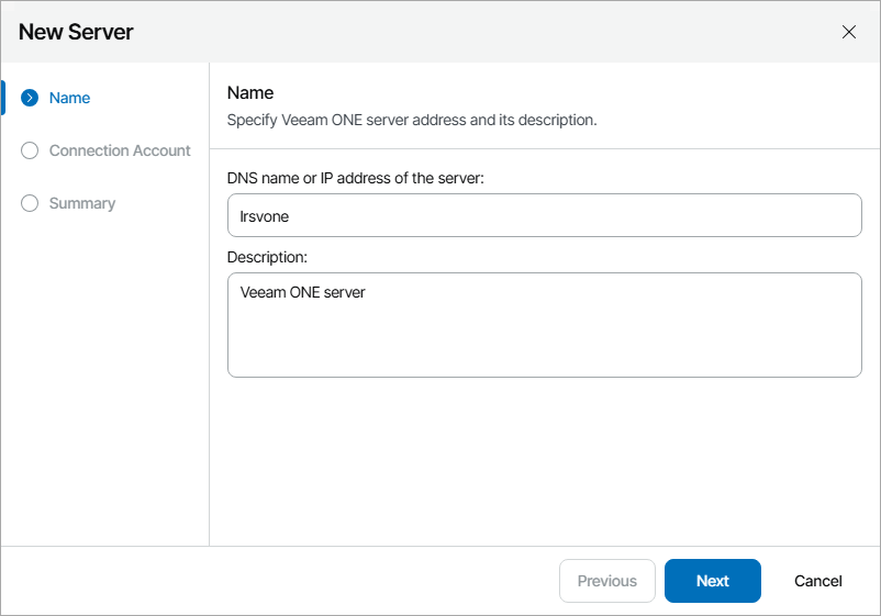

  1. At the Name step of the wizard, specify the following settings:
  1. In the DNS name or IP address of the server field, type FQDN or IP address of the computer where Veeam ONE Server component is deployed.
  2. In the Description field, type server description or comments.
Specify Server Address

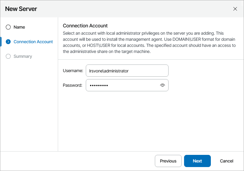

  1. At the Connection Account step of the wizard, specify credentials of a user account with local Administrator privileges on the Veeam ONE server.
This account will be used to install a Veeam Service Provider Console management agent on the Veeam ONE server.
The user name must be specified in the DOMAIN\USERNAME format for domain accounts, or HOST\USERNAME format for local accounts.
Specify Connection Account Credentials

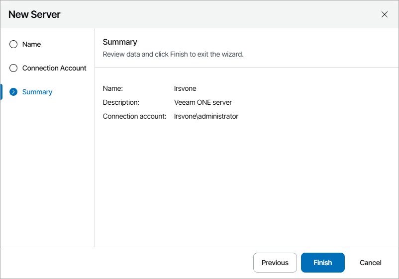

  1. At the Summary step of the wizard, review connection settings and click Finish.
Review Connection Settings
