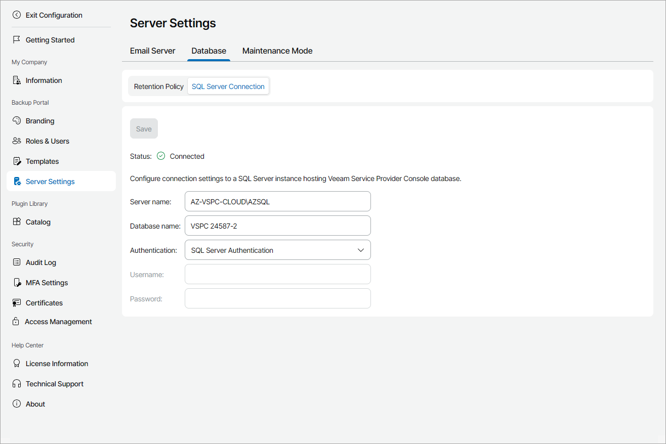

  2. In the configuration menu on the left, click Server Settings.
  3. Open the Database tab and navigate to SQL Server Connection.
  4. In the Server name field, specify a name of a Microsoft SQL Server instance that hosts the Veeam Service Provider Console database.
  5. In the Database name field, specify a name of the Veeam Service Provider Console database.
  6. From the Authentication list, select the type of authentication that Veeam Service Provider Console must use to connect to the Microsoft SQL Server.
  7. [For SQL Server Authentication] In the User name and Password fields, specify credentials of the account that Veeam Service Provider Console must use to connect to the Microsoft SQL Server.
  8. Click Save.

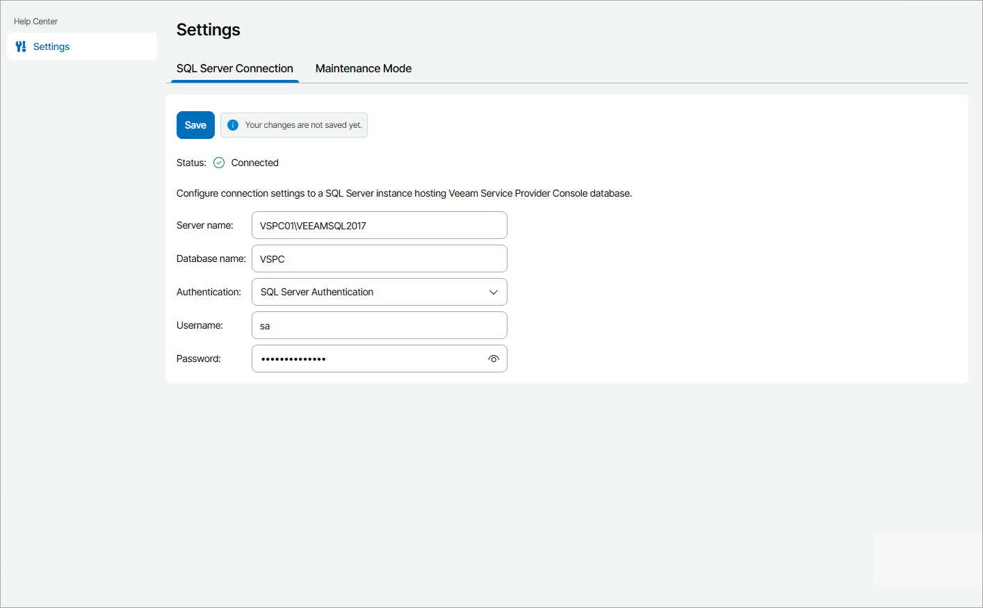

  1. In the Server Settings section, open the Database tab and navigate to SQL Server Connection.
  2. Specify settings for connecting to an existing or a new database as described in Configuring SQL Server Connection Settings.
  • If you specify connection settings for an existing Veeam Service Provider Console database, Veeam Service Provider Console will connect to this database using the specified settings.
  • If you specify the name of a database that does not yet exist on a Microsoft SQL Server, Veeam Service Provider Console will prompt to create a new database, and then will connect to it.
  1. Click Save.
  2. Refresh the Veeam Service Provider Console portal page.
Veeam Service Provider Console will connect to the specified database, and will automatically disable the maintenance mode.
