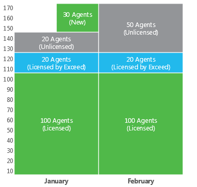

Example
Consider the following example.
Your Rental license covers 100 Veeam backup agents and expires at the beginning of March.
At the beginning of January the number of Veeam backup agents is 140. Veeam Service Provider Console will manage 100 + 20 Veeam backup agents that were registered first (license limit + 20% allowed increase). 20 Veeam backup agents that were registered last will not be managed.
Consider the same example with New Veeam backup agents.
In the middle of January, 30 new Veeam backup agents are registered in Veeam Service Provider Console. Veeam Service Provider Console will manage these Veeam backup agents until the end of the month. If the license is not updated, and the instance pool is not increased, in February Veeam Service Provider Console will change the license statuses as follows:
  • The license status of Veeam backup agents that exceeded the license limit in January will be kept as Licensed by Exceed.
  • 30 Veeam backup agents that were registered in the middle of January will obtain the Unlicensed status.
If a new license covering a larger number of instances is installed, the licenses will be assigned to Veeam backup agents that were registered first.
