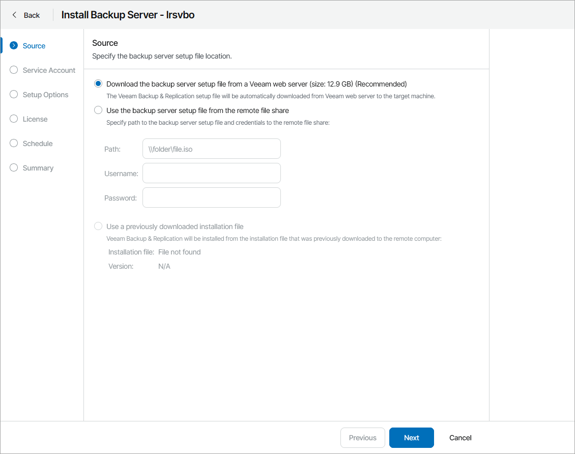

  1. At the Source step of the wizard, specify location of the Veeam Backup & Replication distribution:
  • To use a latest distribution from Veeam Installation Server (over the Internet), select the Download the backup server setup file from a Veeam web server option.
  • To use a distribution stored on a remote file share, select the Use the backup server setup file from the remote file share option and specify remote file share location and credentials of an account that Veeam Service Provider Console will use to connect to the file share.
  • If you have previously downloaded an installation file to the remote computer in Veeam Service Provider Console, select the Use a previously downloaded installation file option. Veeam Service Provider Console will locate the downloaded installation file automatically.
For details on how to download the installation file in Veeam Service Provider Console, see Downloading Setup File.
Specify Source Location

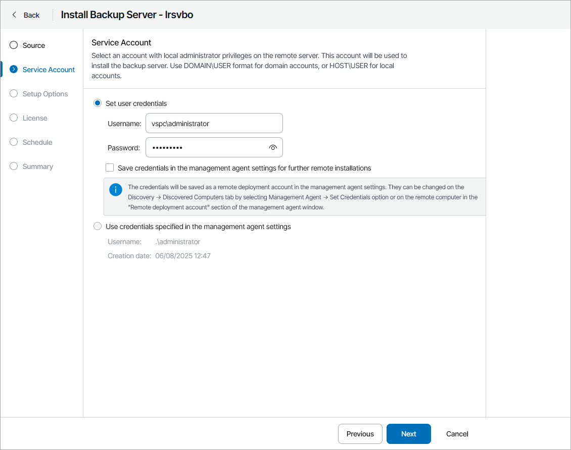

  1. At the Service Account step of the wizard, specify service account credentials:
  • Select the Set user credentials option to set the user name and password.
The account must have local administrator permissions on the remote computer.
To store the user name and password as remote deployment account credentials in the management agent, select the Save credentials in the management agent settings for further remote installations check box. This will allow you to use these credentials to upgrade the Veeam Backup & Replication server in Veeam Service Provider Console.
If you have previously saved credentials in the management agent, you must confirm overwriting the saved credentials.
You can also set or update service account credentials in Veeam Service Provider Console. For details, see Modifying Management Agent Credentials.
  • Select the Use credentials specified in the management agent settings option to use the credentials saved in the management agent settings.

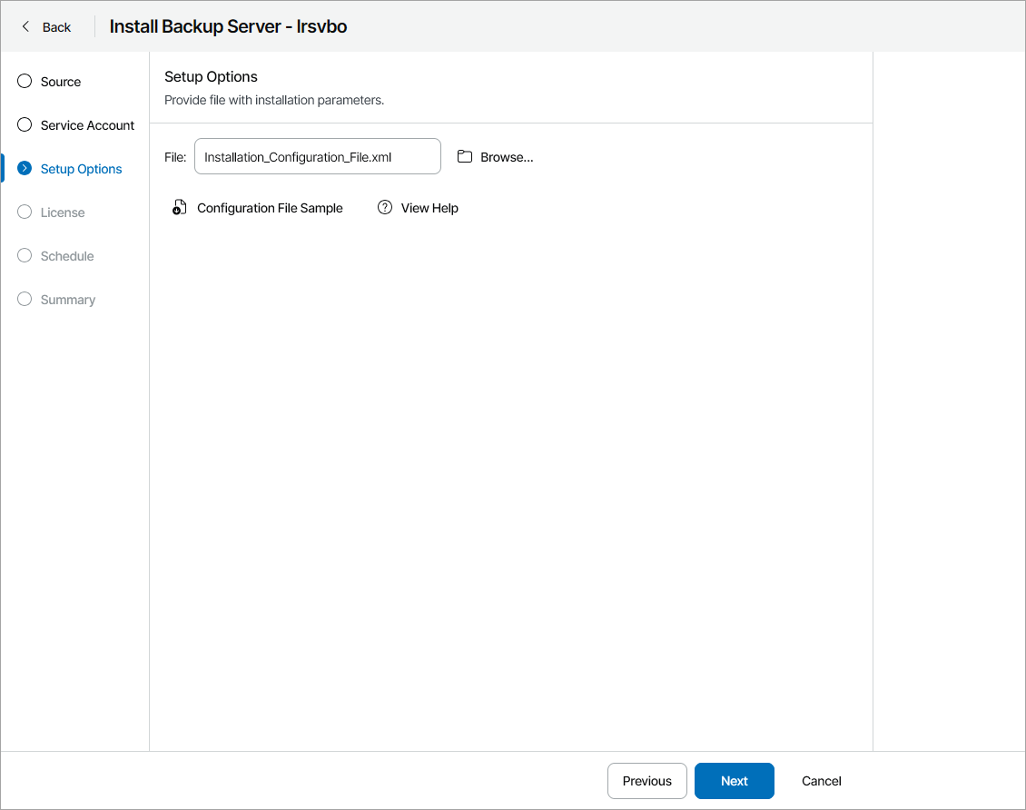

  1. At the Setup Options step of the wizard, specify path to an XML file with installation parameters.
To create a configuration file, click Configuration File Sample to download the file template and fill in the necessary configuration parameters. For details on configuration parameters, see Configuration Parameters.
Provide Configuration File

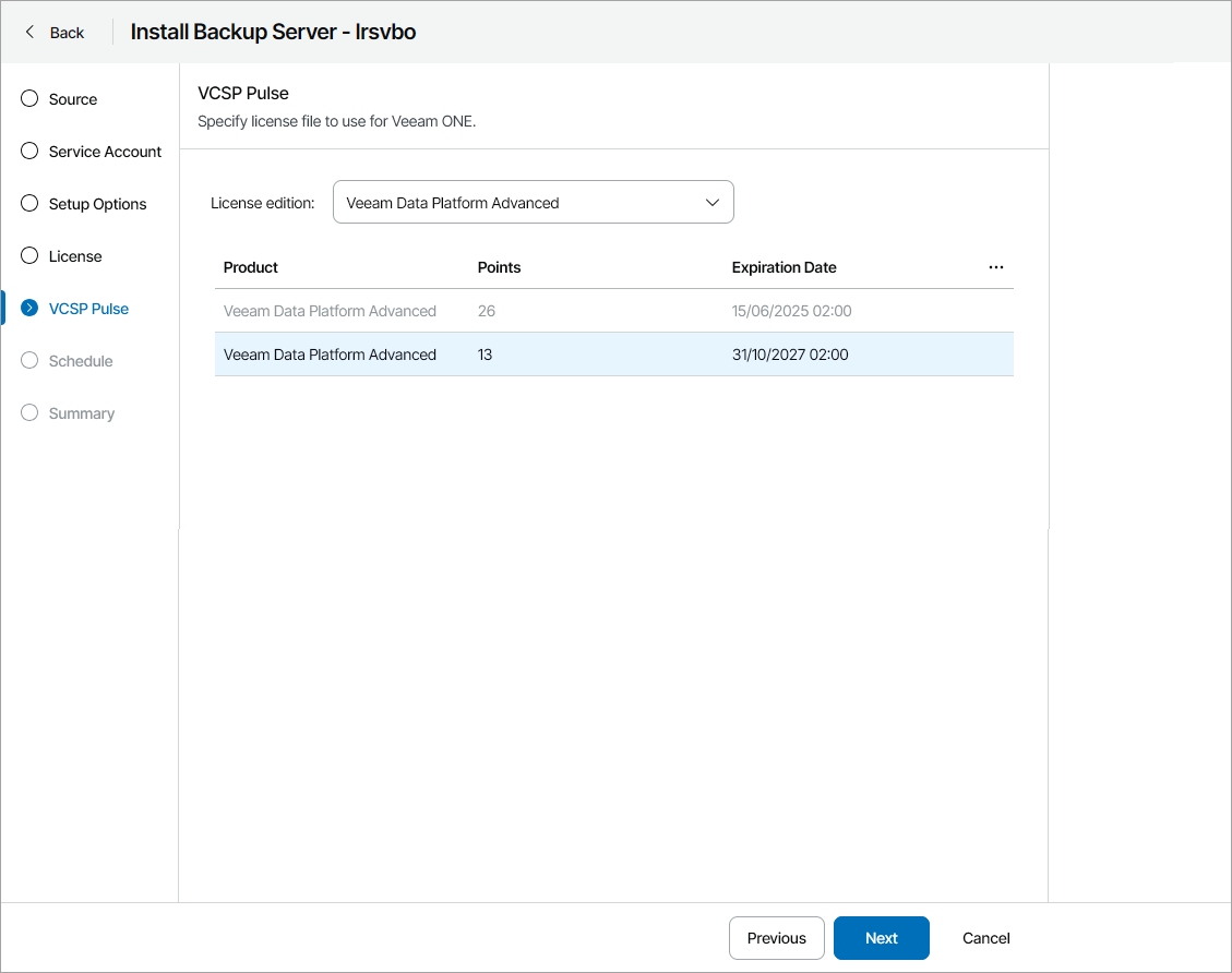

  1. [If you have selected VCSP Pulse at step 9] At the VCSP Pulse step of the wizard, select the necessary license key in the list.
It is not recommended to install one VCSP Pulse license in multiple products. If you have selected a license key that is already installed in another product, Veeam Service Provider Console will ask you to copy the license key. If you do not want to copy the license key, you can download the license file from VCSP Pulse and install it manually. Note that in license usage report Veeam Service Provider Console will add up points usage for all servers with the same license ID.
Select VCSP Pulse License

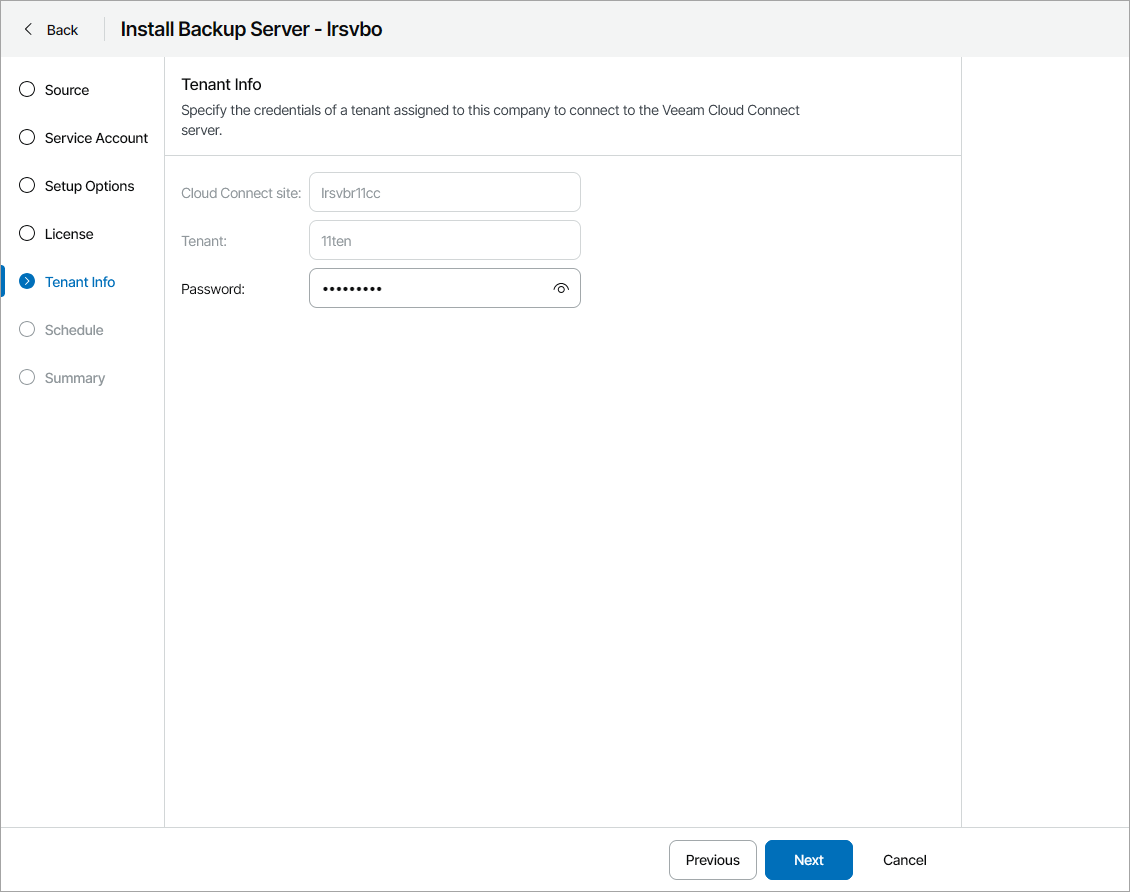

  1. [If you deploy Veeam Backup & Replication on a client computer] At the Tenant Info step of the wizard, specify password for the Veeam Cloud Connect tenant account (for Native Veeam Cloud Connect tenant accounts) or credentials for the VMware Cloud Director organization administrator account (for VMware Cloud Director tenant accounts).
Provide Tenant Password

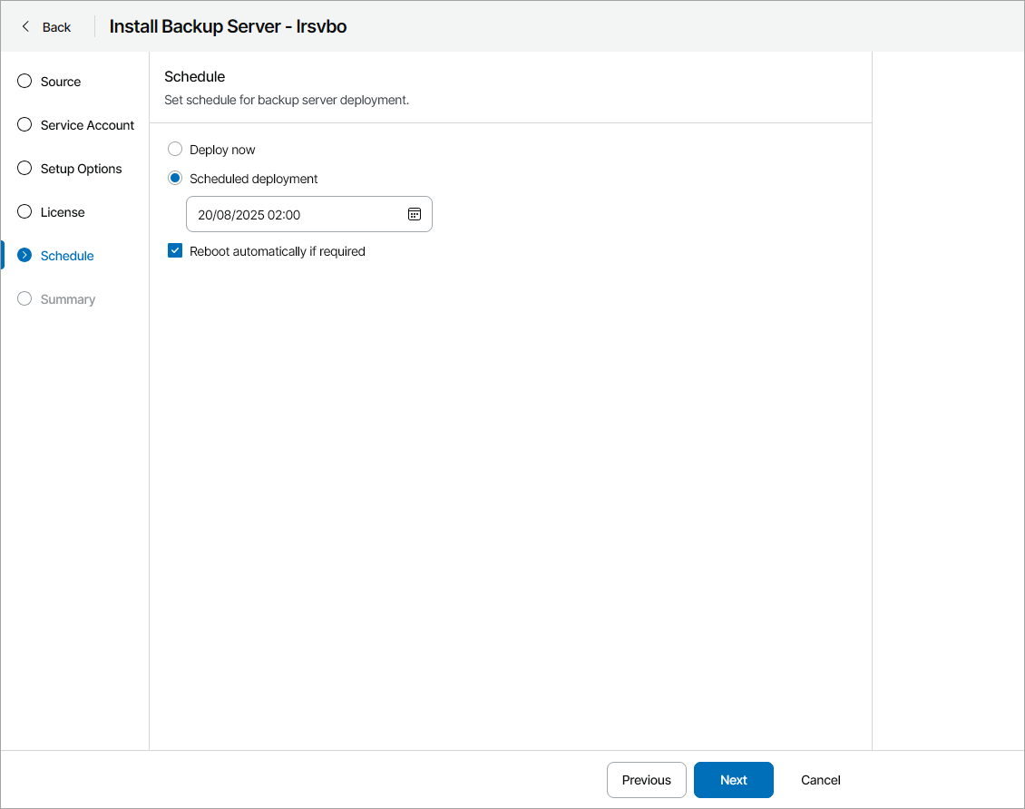

  1. At the Schedule step of the wizard, specify when you want to install Veeam Backup & Replication:
  • To install Veeam Backup & Replication immediately, select Deploy now.
  • To postpone installation, select Scheduled deployment and specify date and time when Veeam Backup & Replication will be installed.
You will be able to reschedule or cancel the installation using the link in the Scheduled Deployment column on the Discovered Computers tab.
If you want to reboot remote computers automatically during Veeam Backup & Replication installation, select the Reboot automatically if required check box. If you do not select the check box, you may need to reboot the backup server manually to complete installation. For details, see Rebooting Remote Computers.
Configure Deployment Schedule

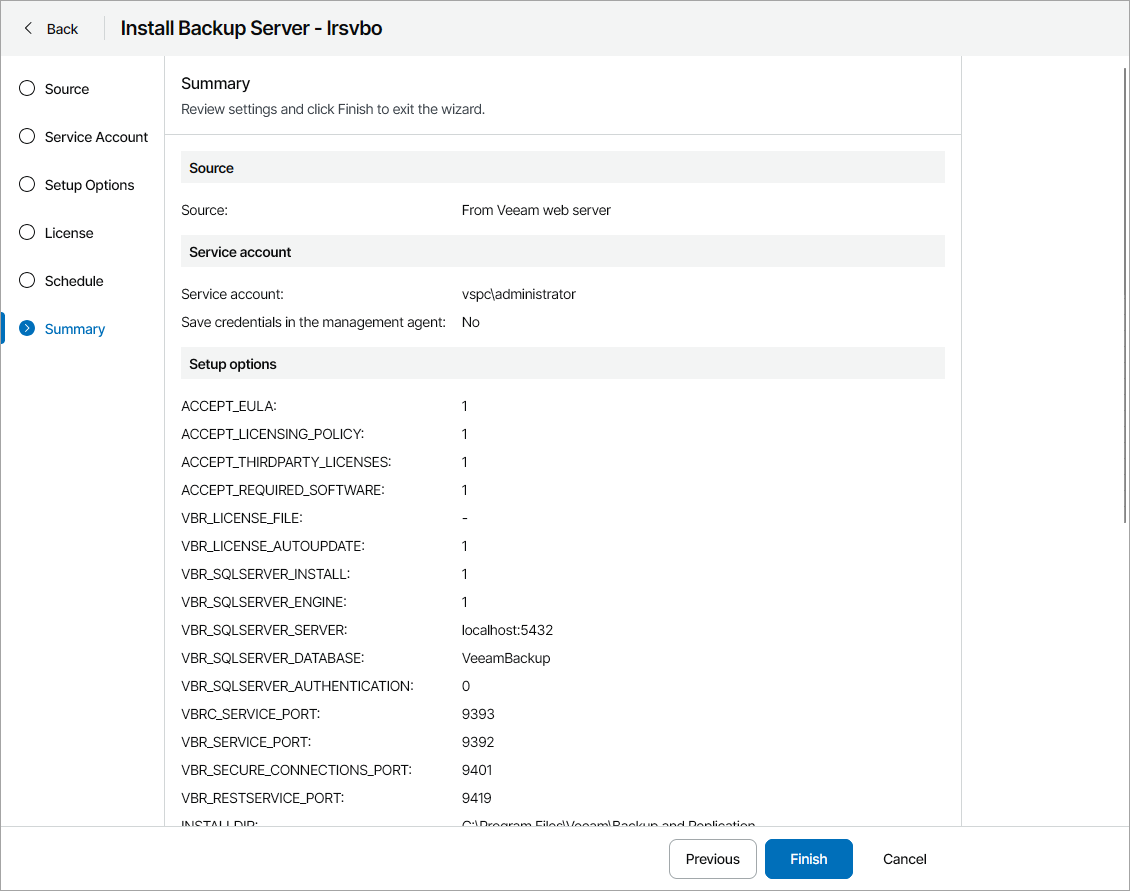

  1. At the Summary step of the wizard, review installation settings and click Finish.
Review Deployment Settings
