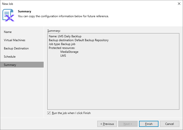

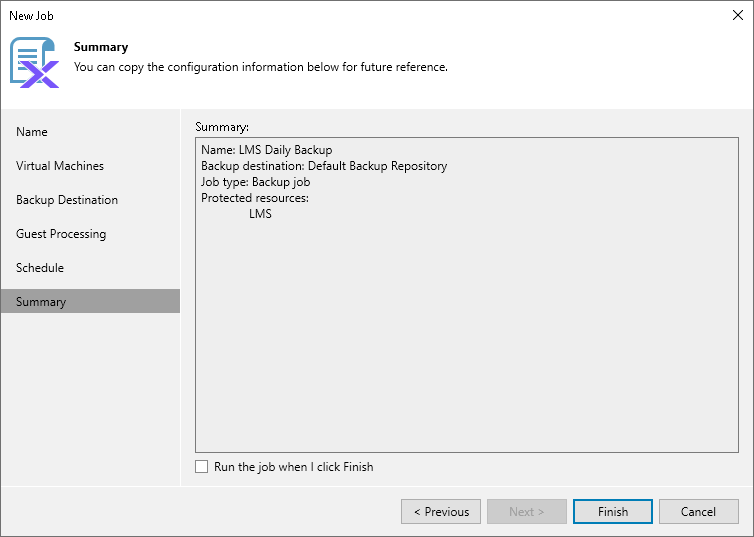

At the Summary step of the wizard, review summary information and click Finish. When Veeam Backup for Nutanix AHV starts the job according to the specified schedule, the backup progress will be displayed on the Session Logs page.
Tip  |
If you want to start the job immediately, select the Run the job when I click Finish check box and then click Finish.  |
