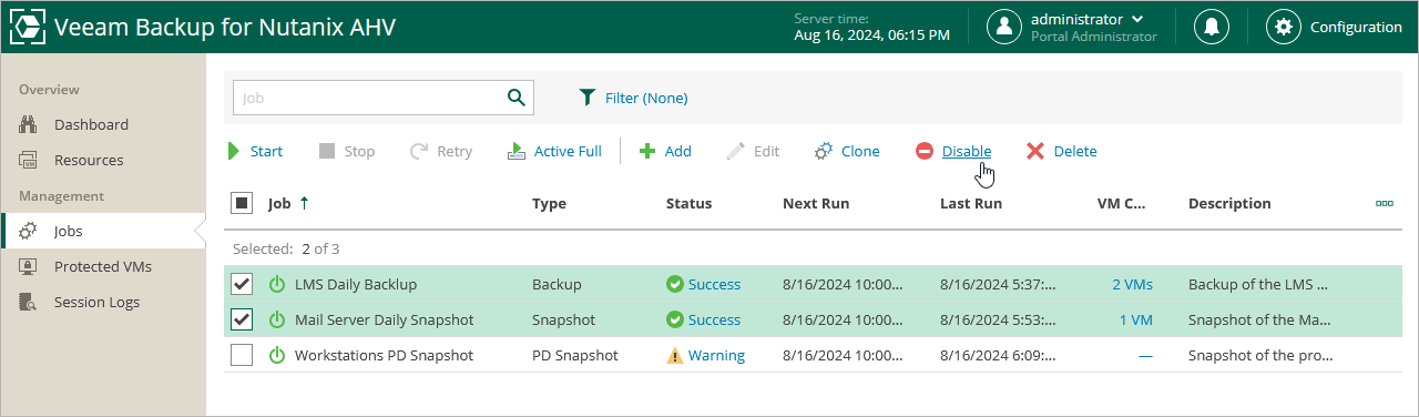

To enable or disable a backup job, do the following:
- Navigate to Jobs.
 - Select the job.
 - Click Enable or Disable.
Tip  |
You can also enable or disable a job using the Veeam Backup & Replication console. To do that, in the inventory pane of the Home view, select Jobs > Backup, select the job and click Enable or Disable on the ribbon.  |
