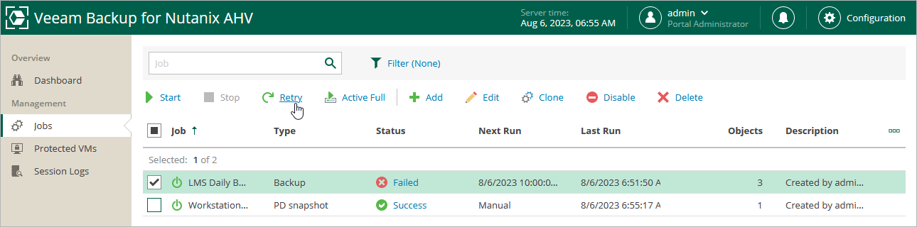

To retry a job, do the following:
- Navigate to Jobs.
 - Select the failed job.
 - Click Retry.
