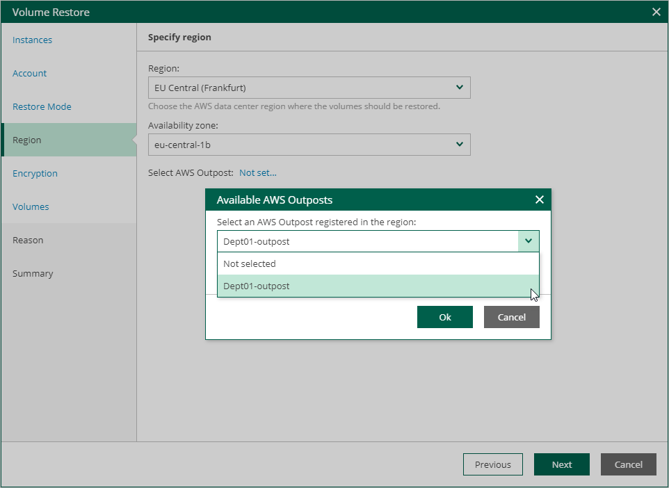

Step 6. Select AWS Region and Availability Zone
At the Region step of the wizard, select the AWS Region and Availability Zone to which Veeam Backup for AWS will place the restored EBS volumes.
If you have AWS Outposts in your infrastructure, you can restore EBS volumes to the AWS Outpost. To do that:
- From the Region drop-down list, select the AWS Region to wchich the AWS Outpost is connected.
- From the Availability zone drop-down list, select the Availability Zone that the AWS Outpost is homed to.
- In the Select AWS Outpost section, click the Not set link.
- In the Available AWS Outposts window, select the AWS Outpost.
- Click Ok.
