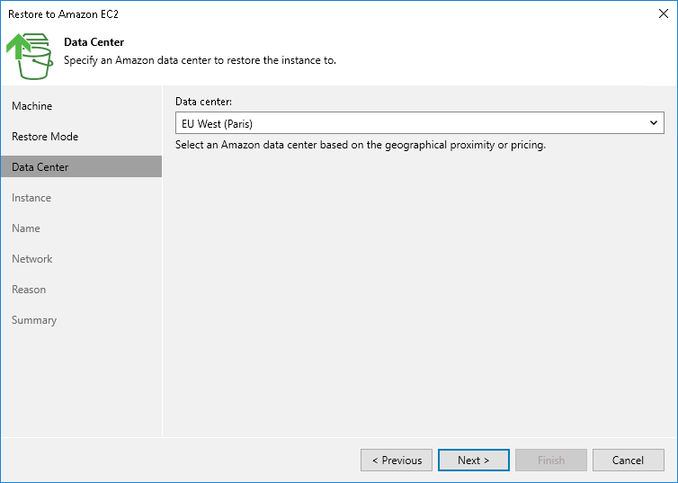

Step 5. Specify Datacenter Region
[This step is available if you have selected the Restore to a new location, or with different settings option at the Restore Mode step of the wizard.]
At the Data Center step of the wizard, select the geographical location of the datacenter where restored EC2 instances will reside.
If the selected location differs from the original location of the EC2 instances, you will see a warning message notifying that the locations do not match. Click Yes to acknowledge the warning. Otherwise, you will not be able to proceed to the next step of the wizard.
