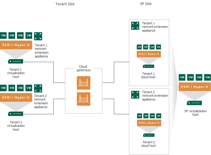

To enable communication between production VMs on the tenant side, VM replicas on the cloud host, backup infrastructure components and external network nodes, Veeam Backup & Replication uses network extension appliances. The network extension appliance is a Linux-based auxiliary VM created on virtualization hosts where tenant VMs and their replicas reside.
For every tenant who plans to replicate VMs to the cloud host and use all built-in cloud networking and failover capabilities (perform both full site failover and partial site failover), at least two network extension appliances should be deployed — one on the SP side and the other on the tenant side.
  • The network extension appliance on the SP side is deployed on the virtualization host in the SP environment that acts as a replication target. The network extension appliance VM is assigned an IP address from the SP production network and placed to the Cloud_Connect_Replication folder and resource pool created on the ESXi host or a dedicated folder on the Hyper-V host.
  • The network extension appliance on the tenant side is deployed on the source virtualization host where production VMs reside. The network extension appliance VM is assigned an IP address from a tenant's production network and placed to the selected folder and resource pool created on the ESXi host or a selected folder on the Hyper-V host.

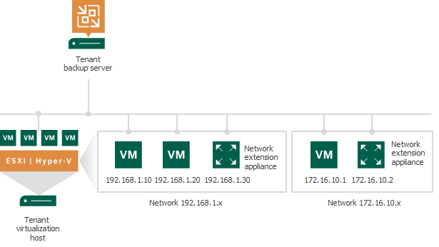

The network extension appliance connects to a production network using a network adapter. On the tenant side, a separate network extension appliance must be deployed for every production IP network. For example, if there are 2 networks on the tenant production site, the tenant should configure 2 network extension appliances. The network adapter of each network extension appliance on the tenant side gets an IP address from the production network for which this appliance is configured.

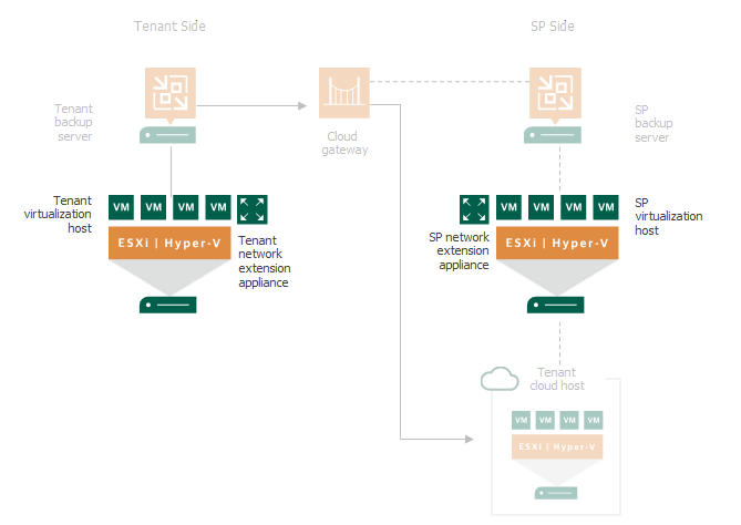

The SP and tenant network extension appliances use a set of networking technologies to automatically establish and maintain a secure connection between a VM network on the tenant side and VM replica network on the SP side. A pair of network extension appliances acts as gateways between the two networks, routing requests from the tenant's production site to VM replicas on the cloud host and in the opposite direction.
When a tenant performs the partial site failover operation, a production VM and a failed-over VM replica on the cloud host begin to communicate to each other using network extension appliances in the following way:
  1. Veeam Backup & Replication powers on a VM replica on the cloud host.
  2. Veeam Backup & Replication powers on a network extension appliance VM on the SP host where the replication target is configured and starts a VPN server on the appliance.
  3. On the tenant side, Veeam Backup & Replication powers on a network extension appliance VM, starts a VPN client on the appliance and connects to the VPN server on the SP network extension appliance to establish a secure VPN tunnel between two appliances through the cloud gateway.
  4. The network extension appliance on the tenant side receives requests from a production VM that are addressed to a failed-over VM and transmits them to the appliance on the SP side through the VPN tunnel.
  5. The network extension appliance on the SP side accepts requests from the tenant appliance and transmits them to the VM replica.
  6. VM replica receives a request from the SP network extension appliance.
  7. VM replica sends a request to the production VM in the similar order.
  8. Production VM and VM replica continue communication through a secure VPN tunnel.
