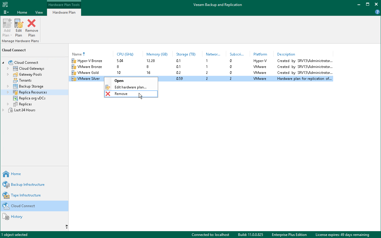

To remove a hardware plan:
  1. Open the Cloud Connect view.
  2. In the inventory pane, click the Replica Resources node.
  3. Do one of the following:
  • Select the necessary hardware plan in the working area and click Remove Plan on the ribbon or right-click the necessary hardware plan and select Remove.
  • Select the necessary hardware plan in the inventory pane and click Remove Plan on the ribbon or right-click the necessary hardware plan and select Remove.
