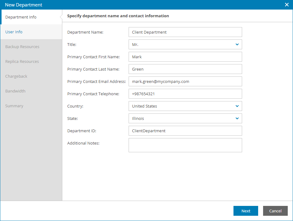

- At the Department Info step of the wizard, specify the department name and contact details.
In this scenario, the department name is Client Department.
The email address you specify at this step will be used for communication with users within the department. At this address, Veeam Availability Console will send email notifications intended for the department. For evaluation purposes, specify in this field an email address that belongs to you, so that you can check notifications sent from Veeam Availability Console.

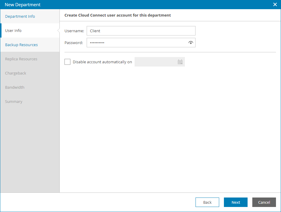

The account you create at this step is called a Department Owner account. Client users will use this account to connect to Veeam Availability Console.

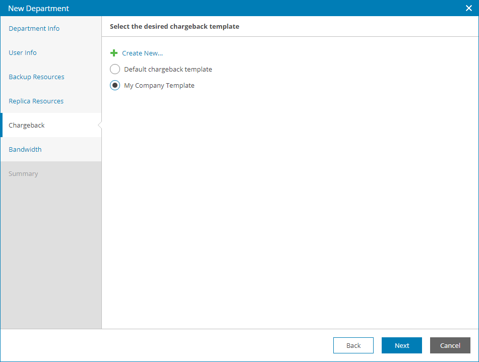

- At the Chargeback step of the wizard, select the chargeback template that you created at the previous step.
The department will be charged in accordance with this chargeback template.

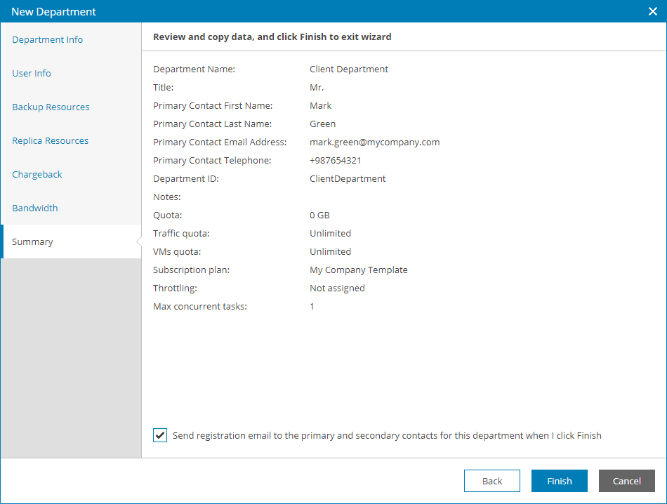

- At the Summary step of the wizard, select the Send registration email to the primary and secondary contacts for this department when I click Finish check box.

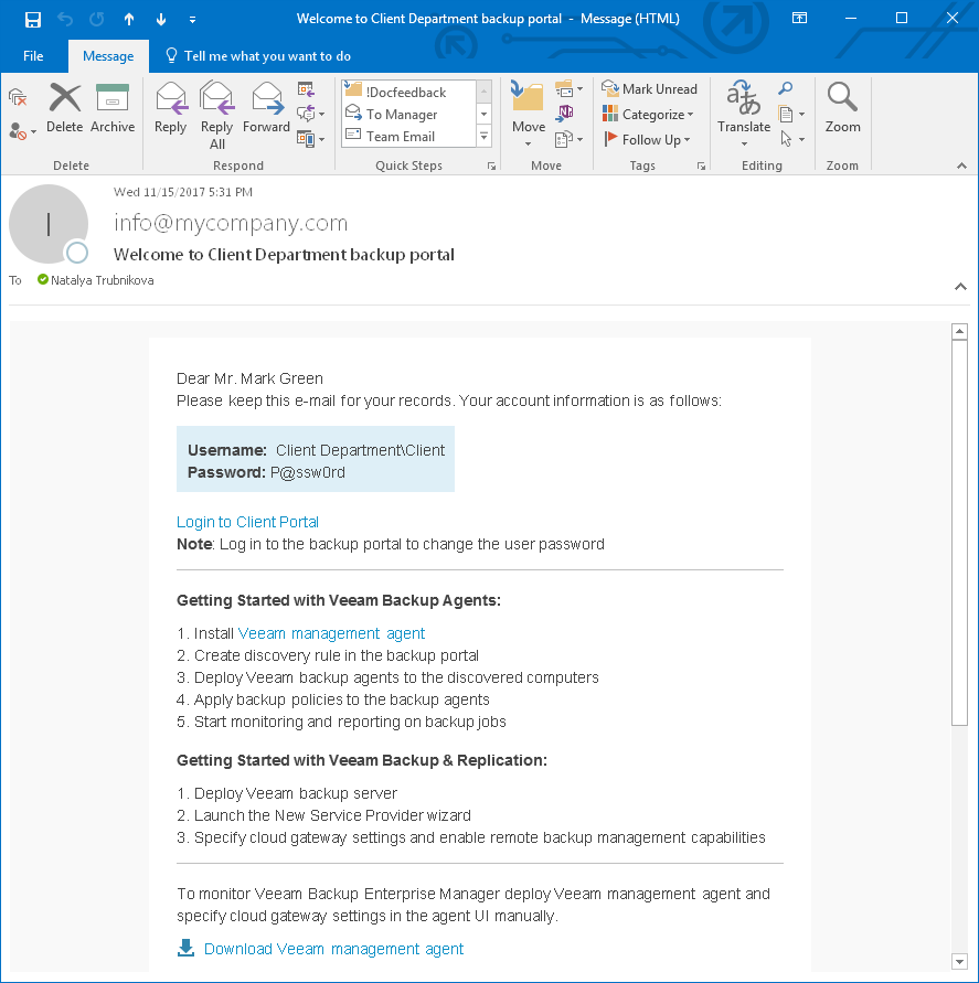

- After you click Finish, Veeam Availability Console will send a welcome email notification at the email address that you specified at the Department Info step.
This notification is intended for the client department and includes instructions for getting started with Veeam Availability Console. If you specified your email address for evaluation purposes, open your mail box and check how the notification looks like.
