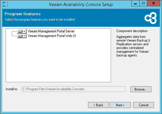

- At the Program Features step of the wizard, make sure that both the Server and Web UI components are selected.
If necessary, you can change the installation directory at this step.

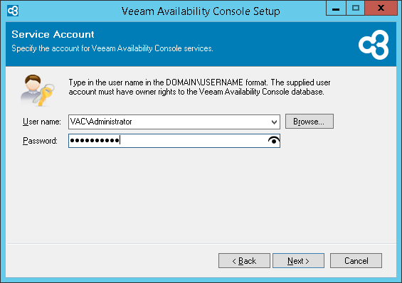

- At the Service Account step of the wizard, type credentials of the account under which Veeam Availability Console services will run.

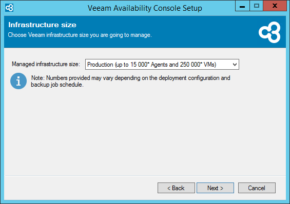

- At the Infrastructure size step of the wizard, select the size of infrastructure that you plan to manage with Veeam Availability Console:
- Evaluation — select this option if you plan to manage not more than 250 Veeam backup agents and 1000 VMs.
- Production — select this option if you plan to manage up to 15 000 Veeam backup agents and 250 000 VMs.

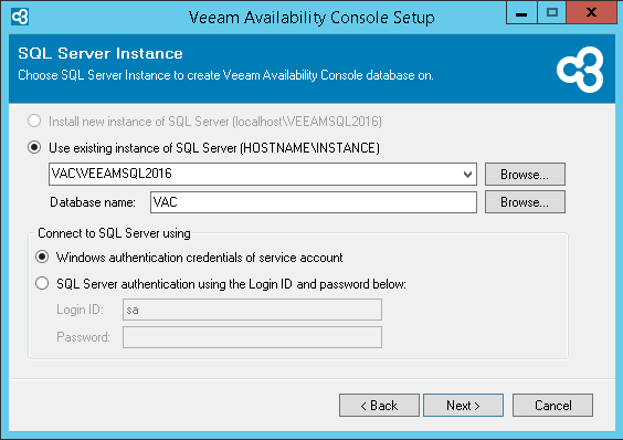

- At the SQL Server Instance step of the wizard, choose a Microsoft SQL Server instance to host the Veeam Availability Console database.
- If you do not have a Microsoft SQL Server instance that you can use for Veeam Availability Console database, select the Install new instance of SQL Server option.
If this option is selected, the setup will install Microsoft SQL Server Express locally, on the machine where you are installing Veeam Availability Console, and will create a database with the default name VAC.
- If you want to use an existing local or remote Microsoft SQL Server instance, select the Use existing instance of SQL Server option and choose a local Microsoft SQL Server instance or browse to a Microsoft SQL Server instance running remotely. You can type the address of the Microsoft SQL Server manually or use the Browse button to choose among available remote instances.
In the Database name field, type the name of a database that will be created for Veeam Availability Console. You can also click the Browse button to choose an existing database.
Provide credentials of an account that will be used by Veeam Availability Console to access the database. You can specify credentials explicitly or use Windows authentication credentials of the Veeam Availability Console service account. For details on permissions required for the account, see Permissions.

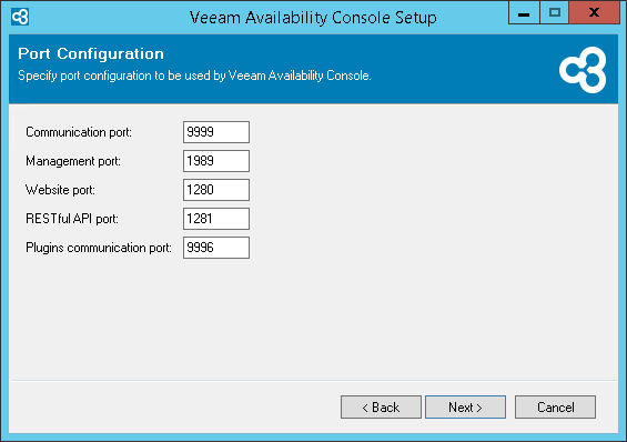

- At the Port Configuration step of the wizard, specify port configuration:
- In the Communication Port field, type a number of the port on the Veeam Availability Console machine that will be used to collect data from cloud gateways and Veeam Cloud Connect server.
The default port number is 9999.
- In the Management port field, type a number of the port that the Veeam Availability Console Web UI component will use to communicate with the Server component.
The default port number is 1989.
- In the Website port field, type a number of the port that will be used to access the Veeam Availability Console website through a web browser.
The default port number is 1280.
- In the RESTful API port field, type a number of the port that will be used to interact with the Veeam Availability Console RESTful API.
The default port number is 1281.
- In the Plugins communication port field, type a number of the port that will be used to interact with ConnectWise Manage plugin.
The default port number is 9996.
