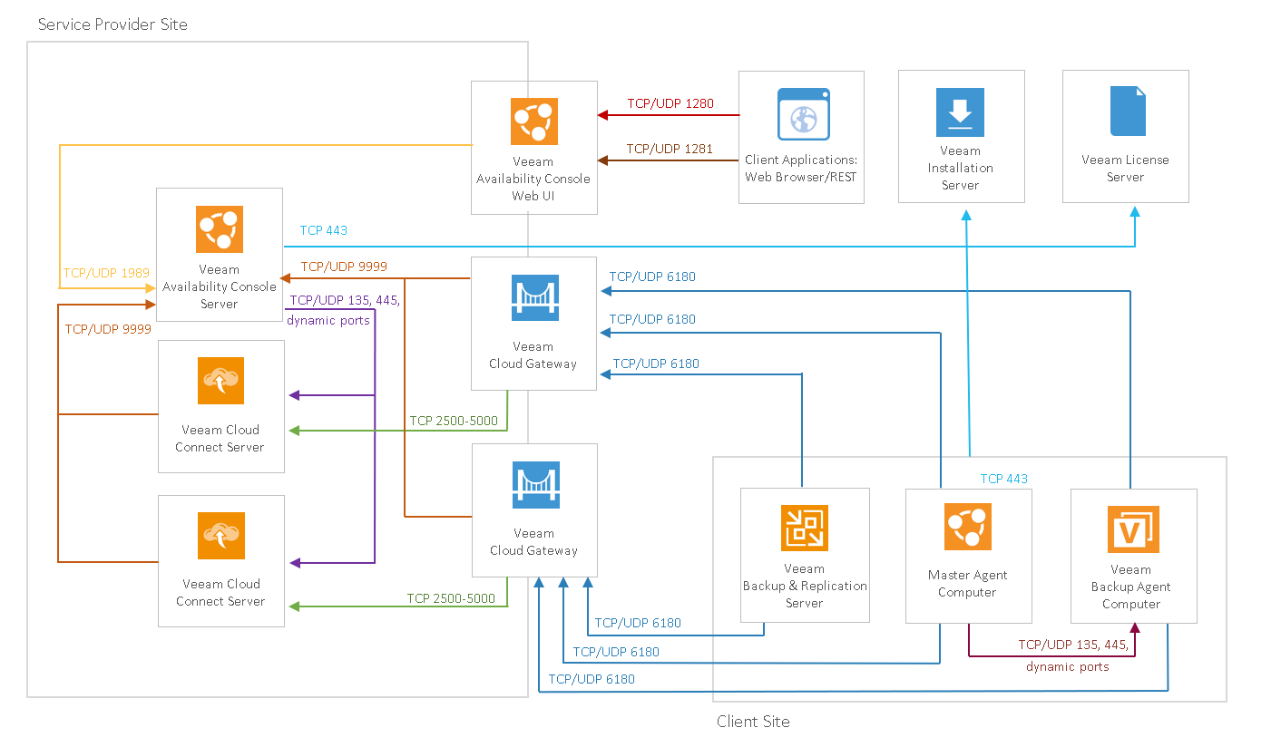

Ports
    The following diagram and table describe ports that must be open to ensure that Veeam Availability Console components and machines interacting with these components can exchange data.

    Veeam Availability Console Web UI
    Veeam Availability Console Server
    TCP, UDP
    1989
    Default port that the Veeam Availability Console Web UI component uses to communicate with the Server component.
    Management agent
    Cloud gateway
    TCP, UDP
    6180
    Default port on a cloud gateway used to transfer traffic from management agents, deployed in a client infrastructure, to cloud gateways.

    Cloud gateway
    Veeam Cloud Connect server
    TCP
    2500-5000
    Port range used during transfer of the management agent from the Veeam Cloud Connect server to a tenant’s backup server.
    The management agent transfer is performed when a Veeam Backup & Replication server is connected to Veeam Availability Console.
    Cloud gateway
    TCP, UDP
    9999
    Default port used to transfer traffic from cloud gateways and Veeam Cloud Connect server to Veeam Availability Console Server component.
    Note: If you deploy Veeam Availability Console server and Veeam Cloud Connect server in different networks, it is recommended to set up a VPN bridge between these networks. Exposing Veeam Availability Console server and Veeam Cloud Connect server ports to the internet is not recommended.

    Web browser
    TCP, UDP
    1280
    Default port used to transfer traffic between Veeam Availability Console Web UI component and a web browser.
    Client application
    TCP, UDP
    1281
    Default port used to exchange RESTful API requests and responses between Veeam Availability Console Web UI component and a client application.
