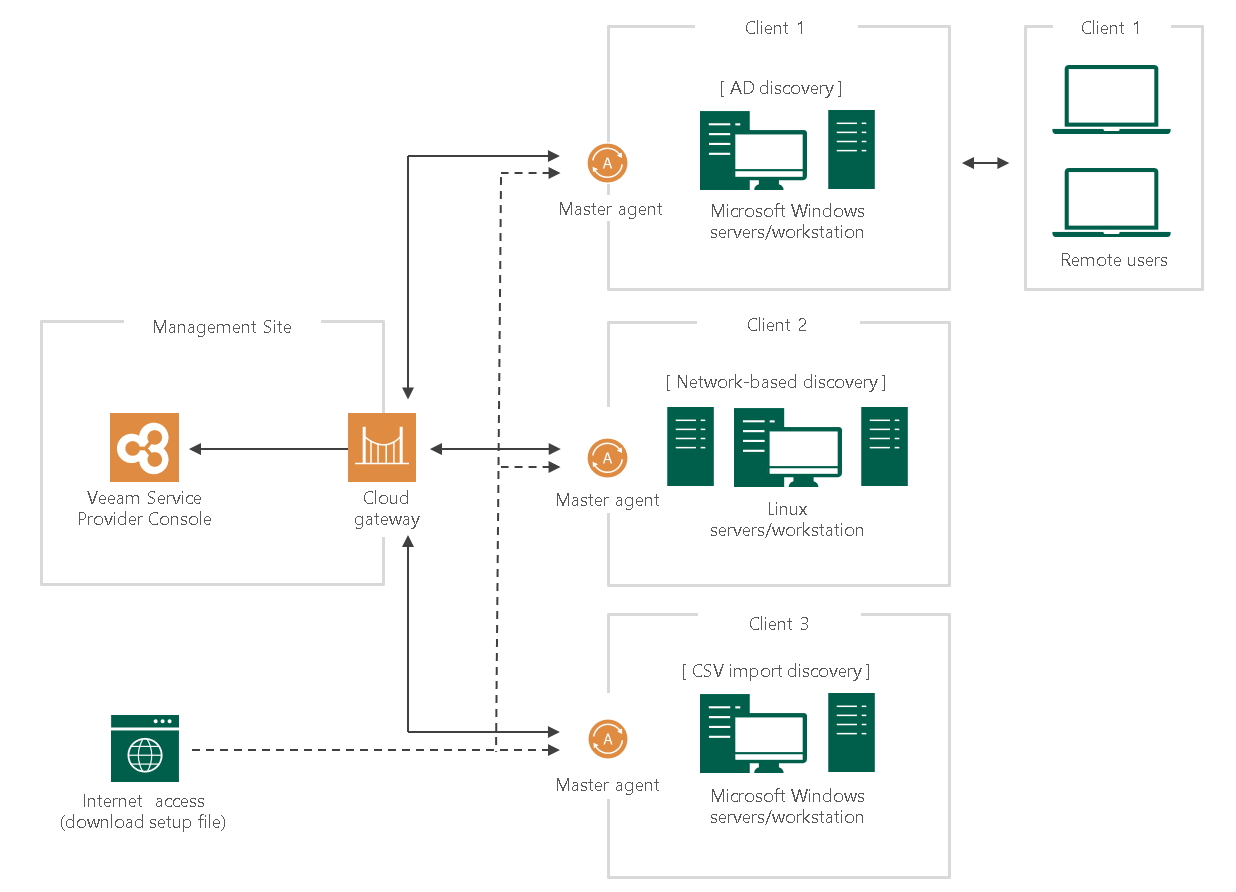

The following diagram provides a high-level pictorial overview of the discovery-based installation method.

- A backup administrator sets up a master agent in a managed location, configures a discovery rule and initiates the discovery process.
The discovery rule describes settings required to perform discovery and (optionally) installation of Veeam backup agents on discovered computers. Discovery rule prescribes what master agent will be used for discovery, what managed computers must be scanned, what account will be used to connect to these computers, whether Veeam backup agents must be installed on discovered computers, and so on.
The discovery rule can use one of the following discovery methods: network-based discovery, Active Directory discovery or import-based discovery.
- The master agent obtains from Veeam Service Provider Console discovery settings specified in the discovery rule. The agent connects to managed computers under the specified account, collects configuration information about each scanned computer through WMI, and communicates information about discovery results to Veeam Service Provider Console.
Information collected from discovered computers includes details on the computer type, platform, host name, guest OS, IP address, MAC address, available applications and information about Veeam backup agent (its presence on the machine, product version and license installed).
- If the discovery rule is configured to install Veeam backup agents on discovered computers and set up a backup job, the master agent initiates these tasks after discovery.
For details on the installation process, see Installation of Veeam Backup Agents.
