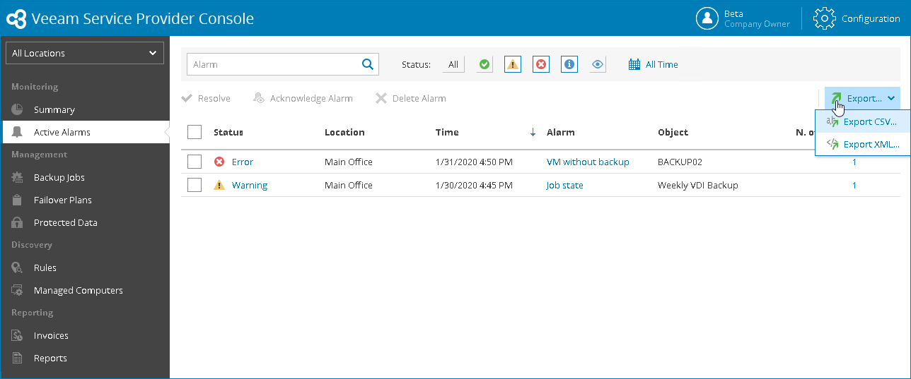

- In the menu on the left, click Active Alarms.
Veeam Service Provider Console will display a list of all triggered alarms.
To narrow down the list of alarms, you can apply the following filters:
- Alarm — search triggered alarms by name.
- Status — limit the list of alarms by the alarm status (Resolved, Warning, Error, Information, Acknowledged).
- Time Period — limit the list of alarms by the time when alarms were triggered.
- Location — limit the list of alarms by location for which alarms were triggered. To limit the list of alarms by location, use filter at the top left corner of the Veeam Service Provider Console window.
- To view information about triggered alarms:
- To view alarm details, click the alarm Status link.
- To view an alarm cause and resolution steps, click the Alarm link.
- To view the history of alarm status changes, click the N of Repeats link. In the displayed window, click Rules to view a condition that caused the alarm status change, or click the Comment link to view information on resolving the alarm.
- To export alarm details, click Export to and choose a format of the exported data:
- CSV — choose this option to structure exported data as a CSV file.
- XML — choose this option to structure exported data as an XML file.
