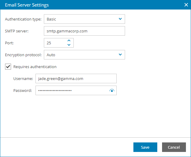

- From the Authentication type list, select Basic.
- In the SMTP server field, specify an FQDN or IP address of the SMTP server.
- If required, change the SMTP communication port in the Port field.
By default, Veeam Service Provider Console uses port 25 for communication with the SMTP server.
- From the Encryption protocol list, select the necessary encryption protocol (Auto, None (not secure), SSL on connect, StartTLS, StartTLS when available).
- If the SMTP server requires authentication, select the Requires authentication check box and specify authentication credentials in the Username and Password fields.
- Click OK.
Veeam Service Provider Console will check the TLS certificate of the SMTP server. If the certificate is not trusted, Veeam Service Provider Console displays a warning.
- To view detailed information about the certificate, click View.
- If you trust the server, click Continue. SMTP server status will be changed to The security certificate is not verified.
- If you do not trust the server, click Cancel.
- To save SMTP server settings, at the top of the page, click Save.

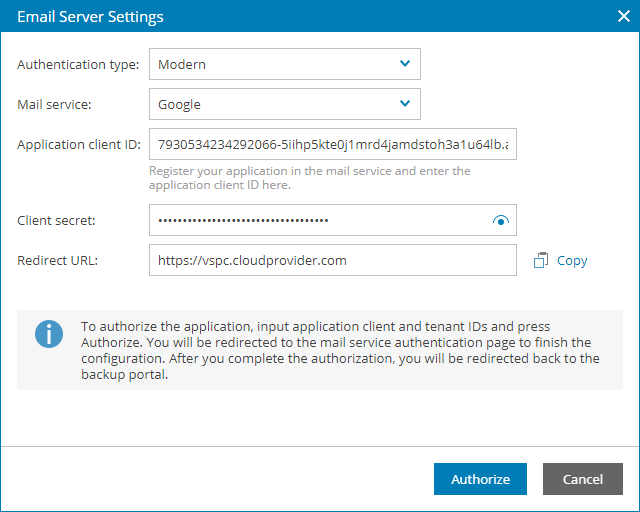

- From the Authentication type list, select Modern.
- From the Mail service list, select your mail service provider (Google, Microsoft).
- In the Application client ID, Client secret and Tenant ID (for Microsoft authentication) fields, specify Veeam Service Provider Console identification parameters in the mail service.
- In the Redirect URL field, check the URL address under which Veeam Service Provider Console must be registered in the mail service.
You can copy the specified URL to register Veeam Service Provider Console in the mail service.
- Click Authorize.
You will be redirected to your mail service provider page. After you complete the authentication, you will be redirected to Veeam Service Provider Console portal and the mail server settings will be saved automatically.

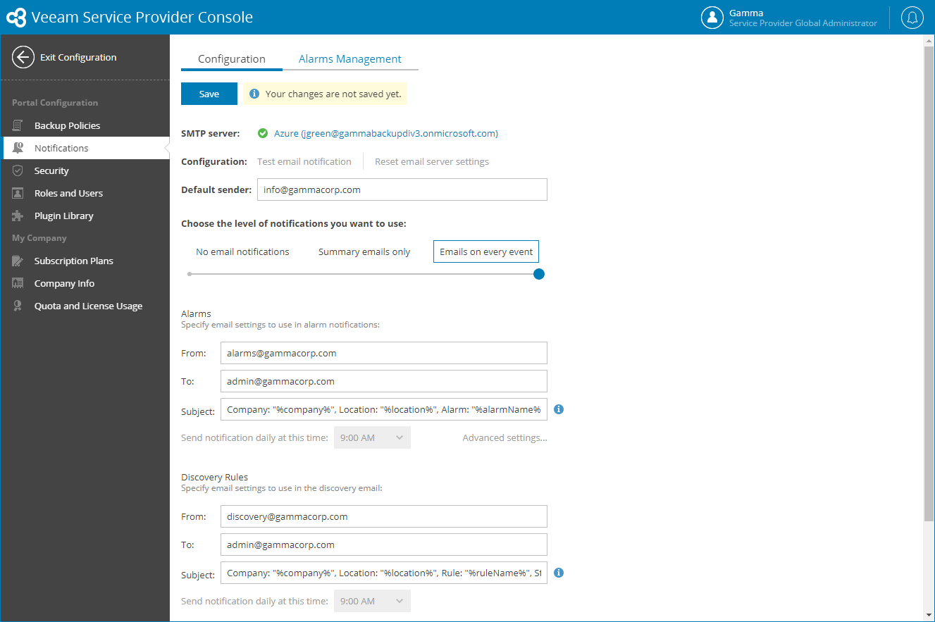

You can choose how often you want to receive email notifications:
- At the top right corner of the Veeam Service Provider Console window, click Configuration.
- In the configuration menu on the left, click Notifications.
- Make sure you have specified SMTP server settings as described in Configuring SMTP Server Settings.
- Use the slider or click the option name to select notification frequency:
- No email notifications
Select this option if you do not want to receive email notifications about triggered alarms and discovery results. Veeam Service Provider Console will use the address specified in your company profile to deliver welcome emails to client companies, subtenant creation emails, invoices and reports that you send manually using product web UI.
- Summary emails only
Select this option if you want to receive daily email notification with information about discovery results for all rules for the past 24 hours and all triggered alarms. Billing and report notifications to companies will be sent automatically after reports and invoices are generated.
- Emails on every event
Select this option if you want to receive notifications for each triggered alarm, every discovery rule, and customize the subject of email notifications. Billing and report notifications to companies will be sent automatically after reports and invoices are generated.
- In the Default sender field, specify the default address that will be displayed in the From field in the notifications sent by Veeam Service Provider Console.
- In the Alarms section, specify settings to use in notifications about alarms:
- In the From field, specify an email address from which notifications must be sent.
An email address specified in this field will be displayed in alarm notifications.
- In the To field, specify an email address at which notifications must be sent.
An email address specified in this field will be used as the recipient address for alarm notifications.
- [For summary emails only] From the Send notification daily at this time drop-down list, select time of the day when the summary daily notification must be sent.
Veeam Service Provider Console will send a summary daily email notification with information about all alarms triggered for the past 24 hours.
- [For summary emails only] Click Advanced settings and specify alarm statuses for which summary daily notifications must be sent and the way alarms will be grouped in the email (by Time or Severity).
- [For emails on every event] To customize the subject of alarm notifications, in the Subject field, type the text that will be displayed as the subject of alarm notifications.
You can use the following variables: %alarmname%, %alarmstatus%, %company%, %location%, %objectname%, %hostname%.
- In the Discovery Rules section, specify settings to use in notifications about discovery results:
An email address specified in this field will be displayed in notifications for discovery rules.
An email address specified in this field will be used as the recipient address for notifications about discovery results.
Veeam Service Provider Console will send a summary daily email notification with information about discovery results for all rules for the past 24 hours.
- [For emails on every event] To customize the subject of discovery notifications, in the Subject field, type the text that will be displayed as the subject of discovery notifications.
You can use the following variables: %company%, %location%, %ruleName%, %ruleStatus%.
- In the Billing section, specify settings to use in billing notifications to clients:
An email address specified in this field will be displayed in billing notifications with invoices to clients.
- To customize the subject of billing notifications, in the Subject field, type the text that will be displayed as the subject of billing notifications with invoices to clients.
You can use the following variables: %company%, %invoicePeriod%.
- At the top of the page, click Save.
