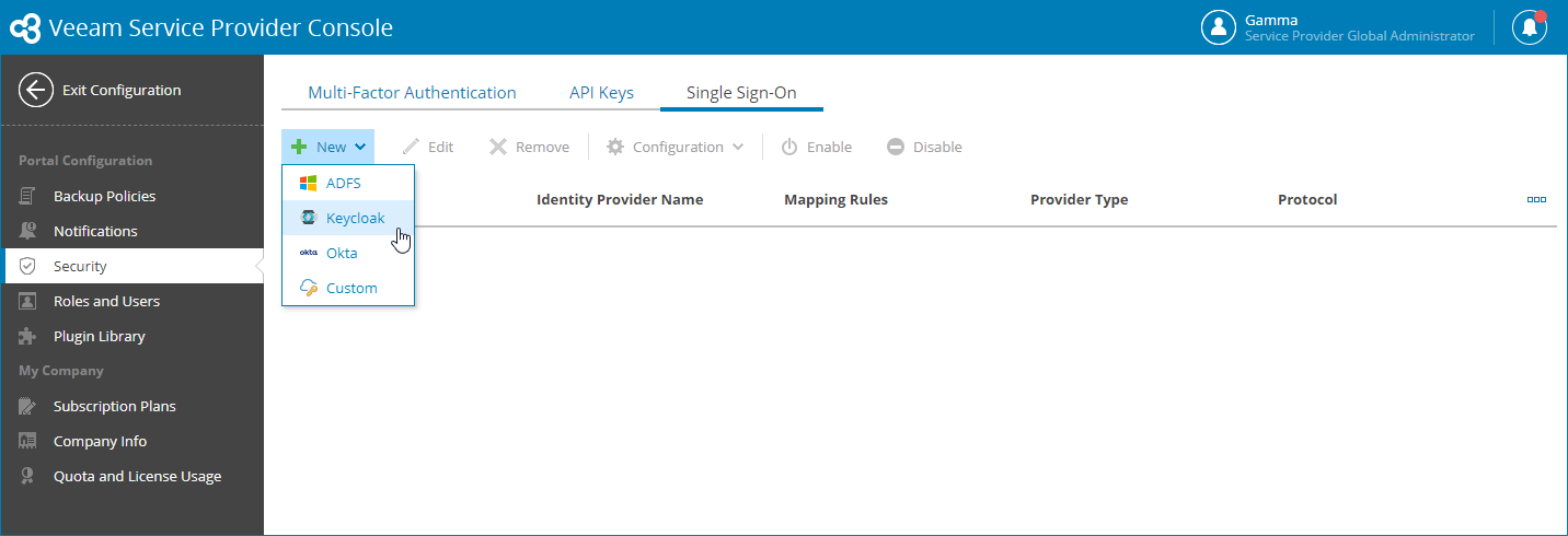

  2. In the configuration menu on the left, click Security.
  3. On the SIngle Sign-On tab, click New and select an identity provider service from the drop-down list.
The identity provider configuration wizard will open.

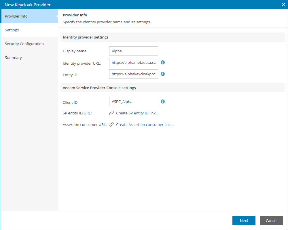

Provider Info
  1. At the Provider Info step of the wizard, specify general information on the IdP:
Note that the name must be at least 5 and not more than 32 characters long and must not contain special characters.
If you apply changes to Client ID value after link generation, click New link.

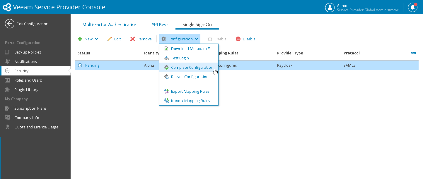

  1. Select the new identity provider in the list.
  2. From the Configuration drop-down list, select Complete Configuration.
If you have mapping rules configured, you can also select Test Login. It allows you to perform a trial authorization. If it is successful, the identity provider configuration is completed automatically.

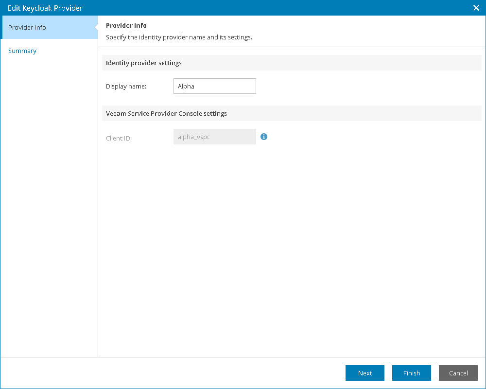

Editing Identity Provider Display Name
To edit an identity provider:
  3. Open the Single Sign-On tab.
  4. Select the identity provider in the list.
  5. At the top of the list, click Edit.
Alternatively, you can right-click the necessary identity provider and choose Edit.
The Edit Identity Provider wizard will open.
  1. In the Display name field, specify a new IdP display name.
  2. Click Finish.

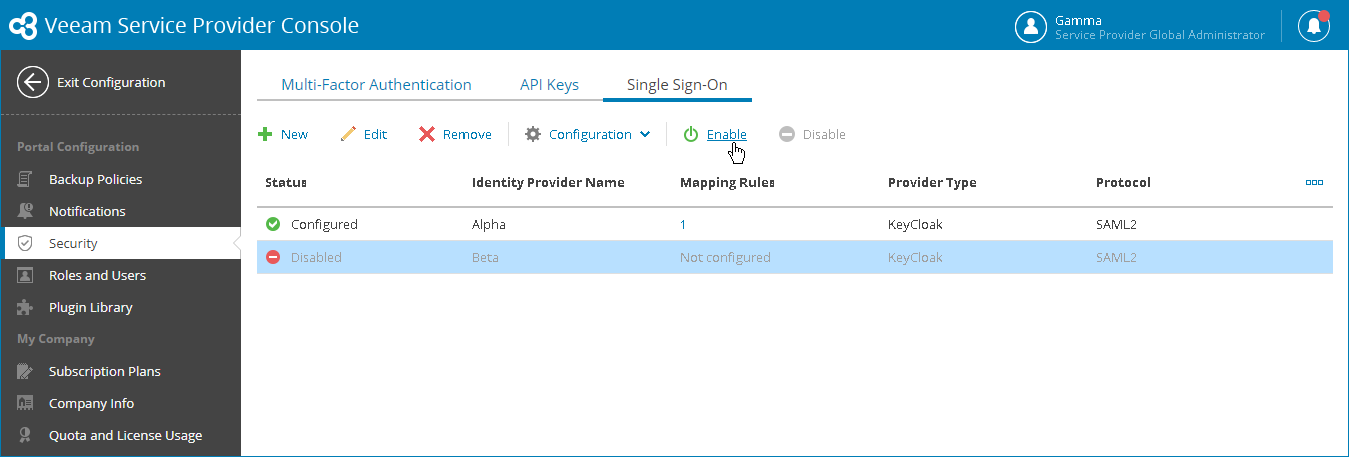

Disabling Identity Providers
Although you can add multiple identity providers, only one of them can be enabled at the same time. If you add a second identity provider, you cannot complete its configuration until another identity provider is enabled. To disable an identity provider:
  5. At the top of the list, click Disable.
Alternatively, you can right-click the necessary identity provider and choose Disable.

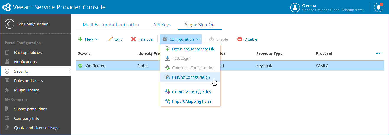

Updating Identity Provider Configuration
You can update IdP configuration saved in Veeam Service Provider Console. This can be useful if changes were applied to a profile on IdP server and IdP configuration in Veeam Service Provider Console must be synchronized with these changes.
To update IdP configuration:
  5. From the Configuration drop-down list, select Resync Configuration.
Alternatively, you can right-click the necessary identity provider, choose Configuration and select Resync Configuration.

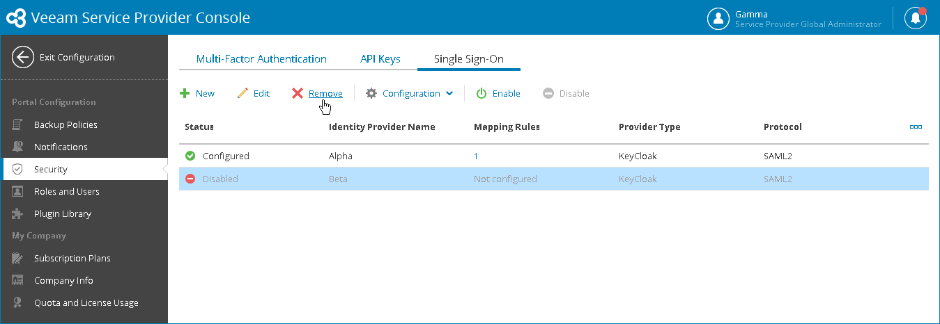

To delete an identity provider:
  5. At the top of the list, click Remove.
Alternatively, you can right-click the necessary identity provider and choose Remove.
Deleting Identity Provider
After you delete an identity provider, all user identities associated with it will also be deleted.

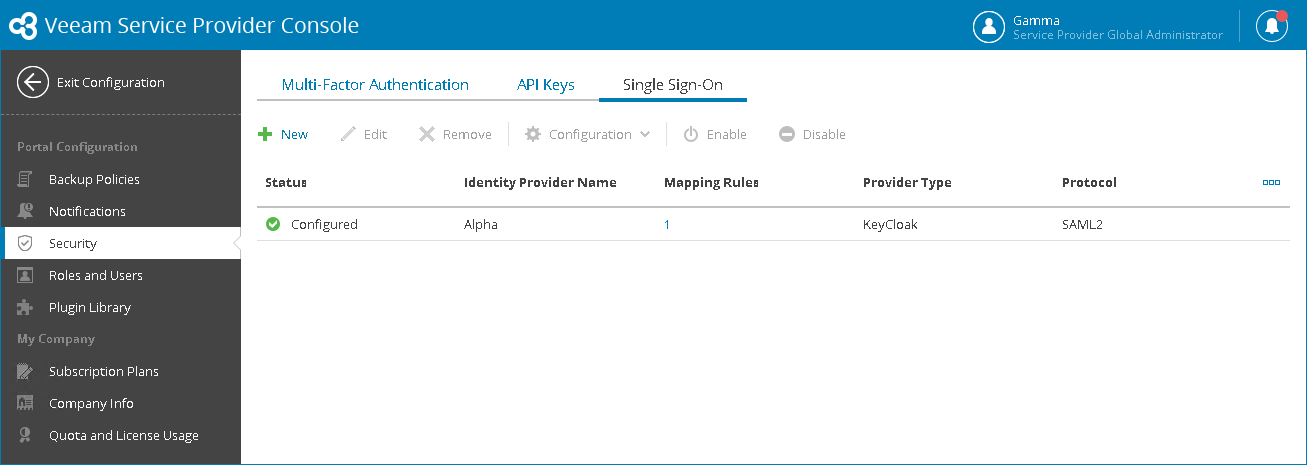

Viewing Identity Provider Details
To view details on configured identity providers:
Each identity provider in the list is described with the following set of properties:
  • Status — status of the IdP.
  • Identity Provider Name — display name of the IdP.
  • Mapping Rules — mapping rules configured for the IdP.
  • Provider Type — name of the IdP service.
  • Protocol — authentication protocol.
