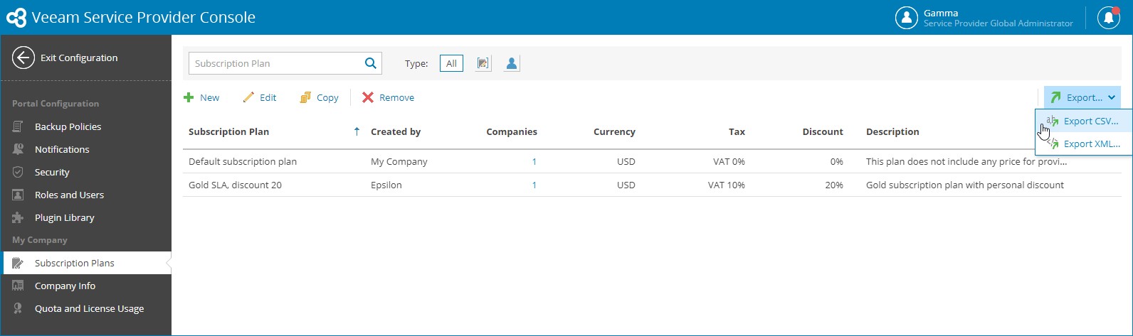

To view and export subscription plan details:
  2. In the configuration menu on the left, click Subscription Plans.
  3. To narrow down the list of subscription plans, you can apply the following filters:
  • Subscription Plan — search subscription plans by plan name.
  • Type — limit the list of subscription plans by creation type (Predefined, My Plans).
  1. To export subscription plan details, click Export to and choose a format of the exported data:
View Subscription Plan Details
Each subscription plan in the list is described with a set of properties. By default, some properties in the list are hidden. To display additional properties, click the ellipsis on the right of the list header and choose properties that must be displayed.
  • Subscription Plan — name of a subscription plan.
  • Companies — number of companies to which a plan is assigned.
You can click this property to view the detailed list of companies.
  • Currency — currency chosen for a subscription plan.
  • Tax — tax type specified for a subscription plan and tax rate amount, in percent.
  • Discount — discount rate specified for a subscription plan.
  • Created By — name of a company whose user created a subscription plan.
  • Description — description of a subscription plan.
