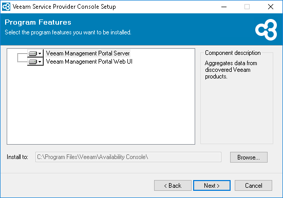

  1. At the Program Features step of the wizard, make sure that both the Server and Web UI components are selected.
If necessary, you can change the installation directory at this step.
Choose Components to Install

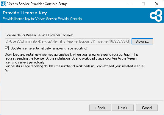

  1. At the Provide License Key step of the wizard, click Browse and point to the license file.
To install new licenses automatically when you renew or expand your contract, select the Update license automatically check box. If you enable the automatic license update, and therefore enable usage reporting, you will double the number of workloads by which you can exceed your installed license. For details, see section Exceeding License Limit of the Guide for Service Providers.
Note that for Evaluation and NFR licenses automatic license update must be enabled. For details on license types, see section License Types of the Guide for Service Providers.
For details on license requirements, see section Licensed Objects of the Guide for Service Providers.
Provide License File

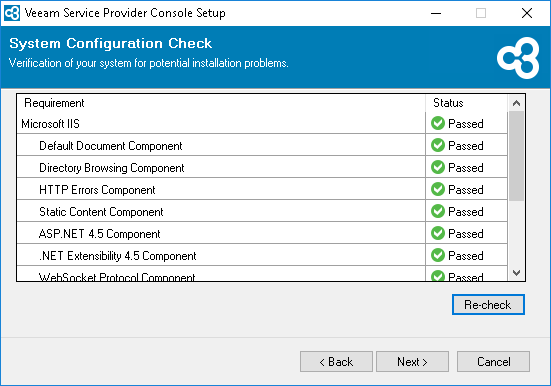

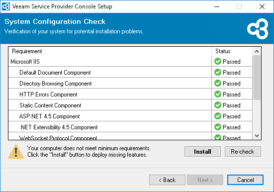

  1. At the System Configuration Check step of the wizard, check what prerequisite software is missing.
Before proceeding with the installation, the installer will perform system configuration check to determine if all prerequisite software is available on the machine. To learn what software is required for Veeam Service Provider Console, see System Requirements.
If some of the required software components are missing, the setup wizard will offer you to install the missing software components and enable missing features automatically. To install the missing software components and enable missing features automatically, click the Install button.
Check Configuration
You can cancel automatic software installation. In this case, you will need to install the missing software components and enable missing features manually (otherwise, you will not be able to proceed to the next step of the setup wizard). After you install and enable all required software components, click Re-check to repeat the system configuration check.
Check Configuration

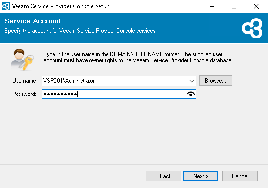

  1. At the Service Account step of the wizard, type credentials of the account under which Veeam Service Provider Console services will run.
Specify Service Account

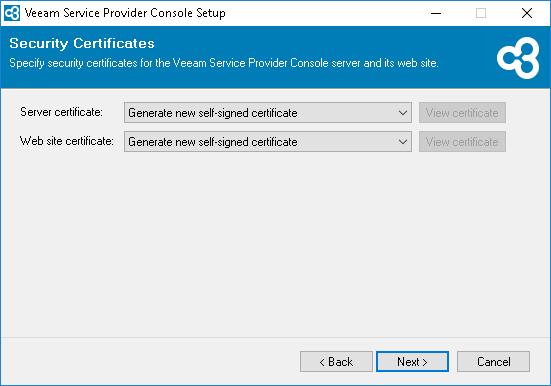

  1. At the Security Certificates step of the wizard, select certificates that will be used to establish secure connection with Veeam Service Provider Console Server and Veeam Service Provider Console Web UI components.
You can choose an existing certificate from the Certificate Store on the machine where you run the installation. If for the Veeam Service Provider Console website you generate or choose a self-signed certificate, you will need to configure a trusted connection between Veeam Service Provider Console and the client application. For details on importing certificates, see Microsoft Docs.
For details on security recommendations and certificates, see section Installing Security Certificates of the Guide for Service Providers.
Select Security Certificates

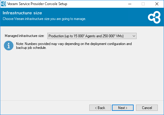

  1. At the Infrastructure size step of the wizard, select the size of infrastructure that you plan to manage with Veeam Service Provider Console:
  • Evaluation — select this option if you plan to manage not more than 250 Veeam backup agents and 1000 VMs.
With this option selected, you will be offered to install Veeam Service Provider Console with the default settings. To specify custom installation settings, on the Default Configuration step of the wizard, select the Let me specify different settings check box. If you want Veeam Service Provider Console to automatically check for managed Veeam products updates, select the Allow Veeam Service Provider Console to check the latest versions of Veeam products check box. When a new product build is published on the Veeam update server, a notification will be displayed in Veeam Service Provider Console.
  • Production — select this option if you plan to manage up to 15 000 Veeam backup agents and 250 000 VMs.
Choose Infrastructure Size

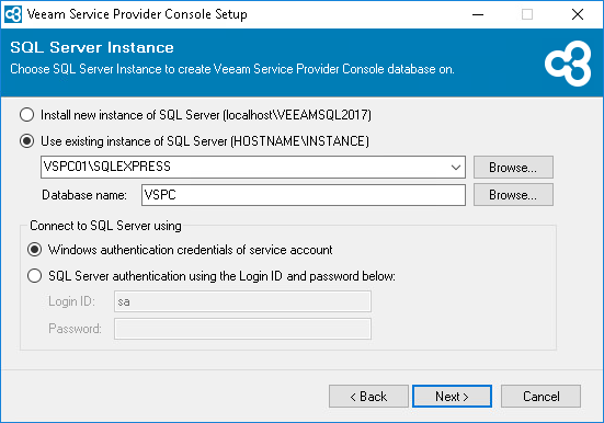

  1. At the SQL Server Instance step of the wizard, choose a Microsoft SQL Server instance to host the Veeam Service Provider Console database.
  • If you do not have a Microsoft SQL Server instance that you can use for Veeam Service Provider Console database, select the Install new instance of SQL Server option. This option is available if at the Infrastructure size step of the wizard you have selected Evaluation.
If this option is selected, the setup will install Microsoft SQL Server Express locally, on the machine where you are installing Veeam Service Provider Console, and will create a database with the default name VSPC.
Note:
  • The Install new instance of SQL Server option is not recommended for large-scale environments. For details on recommended Microsoft SQL Server configuration, see Sizing Guidelines.
  • If at the Infrastructure size step of the wizard you have selected the Production option, you can only use the existing local Microsoft SQL Server instance or choose an instance that runs remotely. The option to install a new Microsoft SQL Server instance will be unavailable.
  • If you want to use an existing local or remote Microsoft SQL Server instance, select the Use existing instance of SQL Server option and choose a local Microsoft SQL Server instance or browse to a Microsoft SQL Server instance running remotely. You can type the address of the Microsoft SQL Server manually or use the Browse button to choose among available remote instances.
If your Microsoft SQL Server instance uses dynamic ports to communicate with Veeam Service Provider Console Server, make sure to open these ports before installation.
In the Database name field, type the name of a database that will be created for Veeam Service Provider Console. You can also click the Browse button to choose an existing database.
Provide credentials of an account that will be used by Veeam Service Provider Console to access the database. You can specify credentials explicitly or use Windows authentication credentials of the Veeam Service Provider Console service account. For details on permissions required for the account, see Permissions.
Choose Microsoft SQL Server

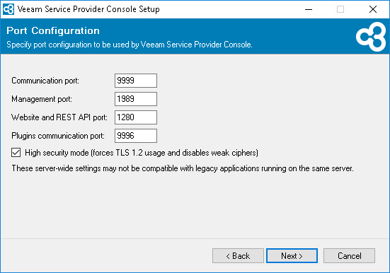

  1. At the Port Configuration step of the wizard, specify port configuration:
  1. In the Communication port field, type a number of the port on the Veeam Service Provider Console machine that will be used to collect data from cloud gateways and Veeam Cloud Connect server.
The default port number is 9999.
  1. In the Management port field, type a number of the port that the Veeam Service Provider Console Web UI component will use to communicate with the Server component.
The default port number is 1989.
  1. In the Website and REST API port field, type a number of the port that will be used to access the Veeam Service Provider Console website through a web browser and to interact with the Veeam Service Provider Console REST API.
The default port number is 1280.
  1. In the Plugins communication port field, type a number of the port that will be used to interact with ConnectWise Manage plugin.
The default port number is 9996.
  1. To enforce TLS 1.2 encryption protocol for communication between the components, select the High security mode check box.
Important!
The High security mode option disables the following Windows Registry settings:
  • Protocols\\SSL 2.0\\Server
  • Protocols\\TLS 1.0\\Server
  • Protocols\\SSL 3.0\\Server
  • Ciphers\\Triple DES 168
  • Ciphers\\RC4 128/128
  • Ciphers\\RC4 40/128
  • Ciphers\\RC4 56/128
For older versions of Microsoft Windows (2008 R2 and earlier), the following Windows Registry settings are enabled instead:
  • Protocols\\TLS 1.2\\Server
  • Protocols\\TLS 1.2\\Client
This may interfere with the operation of 3rd party software installed on the same machine.
Specify Ports

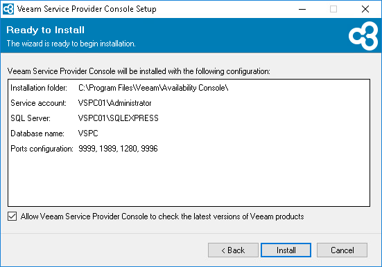

  1. At the Ready to Install step of the wizard, review the provided configuration settings and click Install.
If you want Veeam Service Provider Console to automatically check for managed Veeam products updates, select the Allow Veeam Service Provider Console to check the latest versions of Veeam products check box. When a new product build is published on the Veeam update server, a notification will be displayed in Veeam Service Provider Console. This check box is available only if you have selected the Production option at the Infrastructure size step of the wizard.
Review Installation Settings
