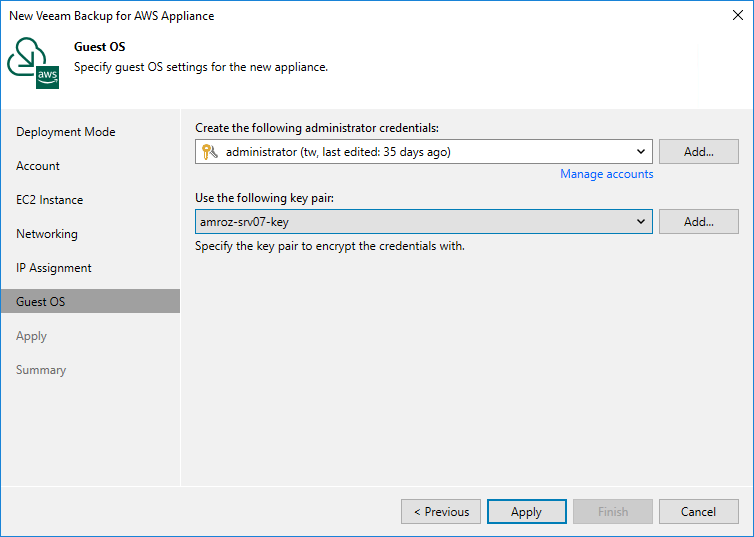

Step 7. Specify User Credentials
At the Guest OS step of the wizard, do the following:
  1. From the Create the following administrator credentials drop-down list, select a user whose credentials will be used by Veeam Backup & Replication to create the default user account on the Veeam Backup for AWS appliance.
For a user to be displayed in the Create the following administrator credentials drop-down list, it must be added to the Credentials Manager. If you have not added a user to the Credential Manager beforehand, you can do it without closing the New Veeam Backup for AWS Appliance wizard. To add a new user, click either the Manage accounts link or the Add button, and specify a user name, password and description in the Credentials window.
The specified password must contain at least one special character, one lowercase and one uppercase letters, and must not contain monotonic sequence characters. The password length must be between 8 and 255 characters.
  1. From the Use the following key pair drop-down list, select a key pair that will be used to authenticate against the Veeam Backup for AWS appliance.
For a key pair to be displayed in the list of available keys, it must be created in AWS as described in AWS Documentation. If you have not created a key pair beforehand, you can do it without closing the Guest OS wizard. To do that, click Add and, in the New Key Pair window, specify a name for the private key and the path to a folder where the private key will be located.
Deploy appliance - Guest OS credentials
