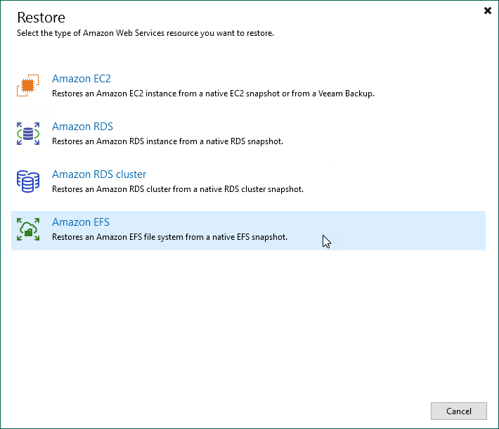

Step 1. Launch Restore to Amazon EFS Wizard
To launch the Restore to Amazon EFS wizard, do the following:
  2. Navigate to Backups > Snapshots.
  3. In the working area, expand the backup policy that protects an EFS file system that you want to restore, select the necessary EFS file system and click Amazon EFS on the ribbon.
Alternatively, you can right-click the selected file system and select Restore to Amazon EFS.
You can also launch the Restore to Amazon EFS wizard from the Home tab. To do that, click Restore and select AWS. In the Restore window, select Amazon EFS.
Restore EFS - Launch
