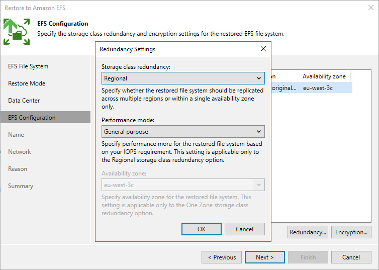

At the EFS Configuration step of the wizard, you can change the configuration and encryption settings for the restored file system. To do that, select the file system and do the following:
  1. Click Redundancy. Then, in the Redundancy Settings window:
  1. Choose whether you want to redundantly store data of the restored file system across all Availability Zones within the selected AWS Region (Regional), or within a single Availability Zone (One Zone).
For more information on storage classes, see AWS Documentation
  1. [This step applies only if you have selected the Regional option] From the Performance mode drop-down list, select whether the restore file system will use the General Purpose or Max I/O performance mode.
For more information on performance modes, see AWS Documentation.
  1. [This step applies only if you have selected the One Zone option] From the Availability zone drop-down list, select an Availability Zone where the restored file system will be located.

Restore EFS - Performance mode
