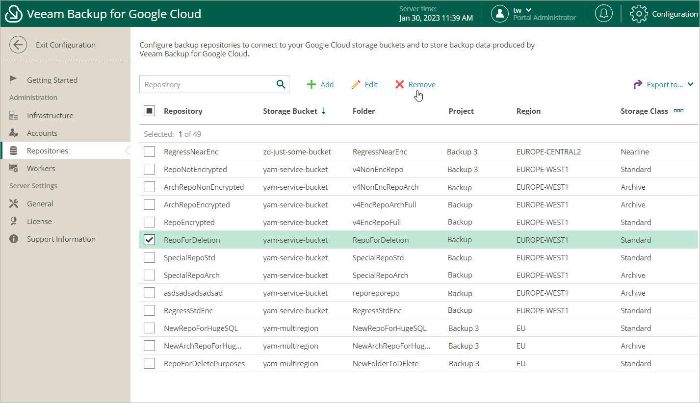

To remove a backup repository from Veeam Backup for Google Cloud, do the following:
- Switch to the Configuration page.
- Navigate to Repositories.
- Select the repository and click Remove.
