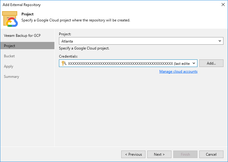

Step 3. Specify GCP Project Settings
                                At the Project step of the wizard, specify project settings of your Google Cloud Storage:
- From the Project drop-down list, select a project where the new archive repository will reside.
For a project to be displayed in the Project list, it must be added to Veeam Backup for GCP. For more information, see Adding Projects in the Veeam Backup for GCP User Guide.
- From the Credentials drop-down list, select the service account to access the project.
If you have not added the service account beforehand in the Cloud Credentials Manager, click Manage cloud accounts or Add to add the necessary credentials.
