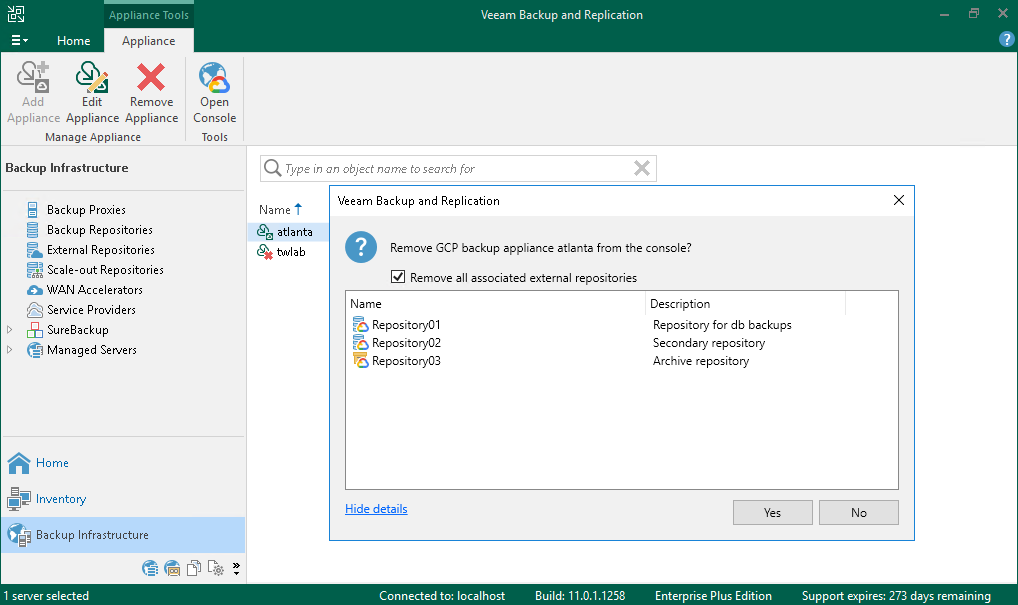

    To remove an appliance from the Veeam Backup & Replication infrastructure:
    2. In the inventory pane, select Managed Servers.
    3. In the working area, select the appliance that you want to remove, and click Remove Appliance on the ribbon. Alternatively, right-click the appliance and select Remove.
    4. In the Veeam Backup & Replication window, do the following:
    1. If you want to remove all the external repositories connected to the appliance, leave the Remove all associated external repositories check box selected. To view the list of external repositories connected to the appliance, click Show details.
    If you want to leave the repositories in the Veeam Backup & Replication infrastructure, clear the Remove all associated external repositories check box.
    1. Click Yes.
    Remove appliance
