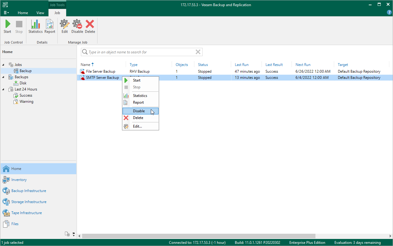

To enable or disable a backup job, do the following:
- In the Veeam Backup & Replication console, open the Home view.
- In the inventory pane, select Jobs > Backup.
- In the working area, select the job and click Enable or Disable on the ribbon, or right-click the job and select Enable or Disable.
