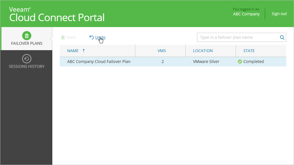

To undo failover by a cloud failover plan:
- Log in to Veeam Cloud Connect Portal. The Failover Plans view will automatically open.
- In the working area, select the necessary cloud failover plan and click Undo.
To quickly find the necessary cloud failover plan, you can use the search field at the top-right of the working area.
