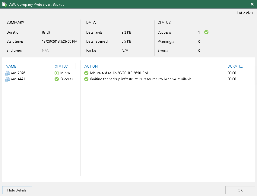

    The real-time statistics provides detailed data on job sessions: duration, start and end time, amount of sent and received data and details of the session performance, for example, warnings and errors that have occurred in the process of operation.
    In addition to overall job statistics, the real-time statistics provides information on each object processed with the job. To view the processing progress for a specific object, select it in the list on the left.

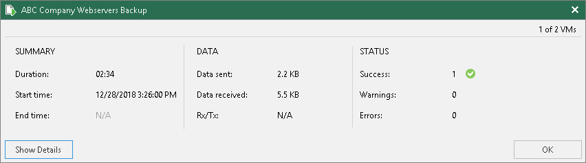

    Viewing Real-Time Statistics Tip:
    To collapse and expand the real-time statistics window, use Hide Details and Show Details buttons at the bottom left corner of the window.

    Statistics Counters
    Veeam Backup & Replication displays jobs statistics for the following counters:
    • At the top of the window, Veeam Backup & Replication displays the number of VMs in the job and the number of processed VMs.
    • The Summary box shows general information about the job:
      • Duration — time from the job start till the current moment or job end.
      • Start time — time of the job start.
      • End time — time of the job end.
    • The Data box shows information about processed VM data:
      • Data sent — amount of data sent from the SP side to the tenant side.
      • Data received — amount of data transferred from the tenant side to the SP side.
      • Rx/Tx — data transfer speed (displayed for currently running jobs only).
    • The Status box shows information about the job results. This box informs how many tasks have completed with the Success, Warning and Error statuses (1 task per 1 VM).
    • The pane at the lower left corner shows a list of objects included in the job. For tenant jobs, Veeam Backup & Replication does not display names of objects included in the job. Instead, it displays identifiers for the objects that Veeam Backup & Replication saves in the configuration database.
    • The pane at the lower right corner shows a list of operations performed during the job. To see a list of operations for a specific object included in the job, click the object in the pane on the left. To see a list of operations for the whole job, click anywhere on the blank area in the left pane.
