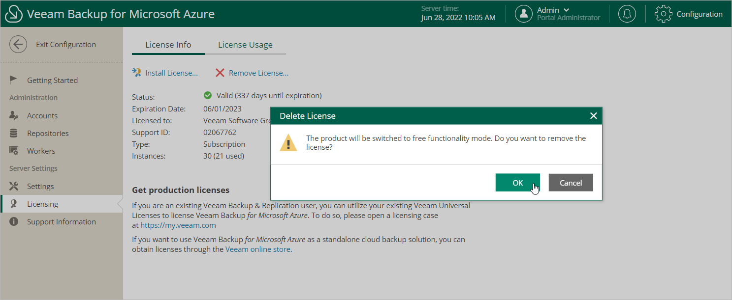

Removing License
To remove a license installed on the backup appliance if you no longer need it, do the following:
- Switch to the Configuration page.
- Navigate to Licensing > License Info.
- Click Remove License.
After you remove a license, Veeam Backup for Microsoft Azure will automatically switch back to the Free edition. In this case, according to the FIFO (first-in first-out) queue, only the first 10 instances registered in the configuration database will remain protected. You can revoke license units from these instances as described in section Revoking License Units.
