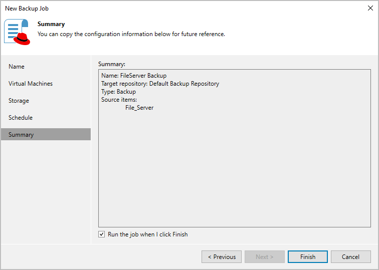

At the Summary step of the wizard, review summary information and click Finish. As soon as Veeam Backup for RHV starts the job, the backup progress will be displayed in the working area when you navigate to Jobs > Backups in the inventory pane of the Home view.
If you want to start the job immediately, select the Run the job when I click Finish check box and then click Finish.
