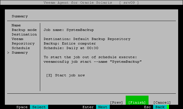

At the Summary step of the wizard, complete the backup job configuration process.
  1. Review the settings of the configured backup job.
  2. To start the job after you close the wizard, make sure that the Start job now check box is selected.
If you want to start the backup job later, you can clear the Start job now check box. You will be able to start the backup job manually at any time you need. To learn more, see Starting Backup Job.
  1. Switch to the Finish button and press [Enter] to exit the wizard.
