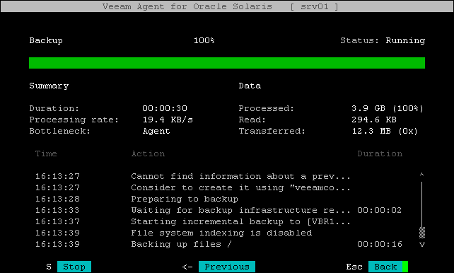

Viewing Session Logs in Control Panel
To view the logs of a specific backup job session using the Veeam Agent control panel, do the following:
  1. Launch the Veeam Agent control panel with the veeam or veeamconfig ui command.
  2. In the Veeam Agent control panel, in the Latest backup sessions list, select the necessary backup job session with [Up] and [Down] keys and press [Enter].
Veeam Agent will display the statistics and logs of the selected session.
