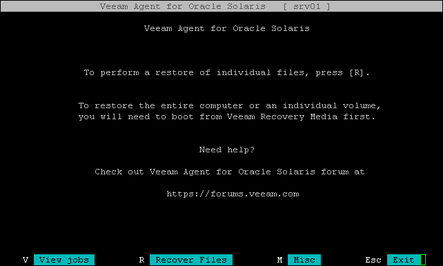

To launch the Veeam Agent control panel, you can use the following commands:
veeamconfig ui |
or
veeam |
Navigating Veeam Agent for Oracle Solaris Control Panel
In the Veeam Agent control panel, the use of a mouse is not supported. To start an operation, you need to use a specific key on your keyboard. For example, you can press the [V] key to view the list of configured backup jobs, press the [S] key to start a backup job or press the [R] key to start the file-level restore process. Short help information about the currently available operations and keys is displayed at the bottom of the control panel.
