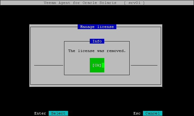

  1. Launch the Veeam Agent control panel with the veeam or veeamconfig ui command.
  2. In the Veeam Agent control panel, press the [M] key to open the Miscellaneous menu.
  3. In the menu, make sure that the Manage License option is selected and press [Enter].
  4. In the Manage license window, press [Tab] to select the Remove button, then press [Enter].
  5. Veeam Agent will remove the license and display a window notifying that the license is successfully removed. Press [Enter] to finish the license removal process.
