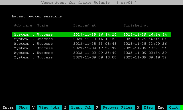

Viewing Job Session Result in Control Panel
To view the result of a session in the Veeam Agent control panel, do the following:
  1. Launch the Veeam Agent control panel with the veeam or veeamconfig ui command.
  2. In the Latest backup sessions list, you can see the result of each session in the State column.
