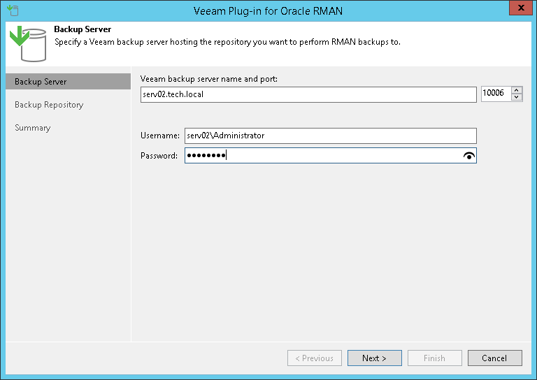

- At the Backup Server step of the wizard, specify the DNS name of the Veeam Backup & Replication server and credentials that will be used to connect to the server. The specified account must have the local Administrator permissions on the Veeam Backup & Replication server.

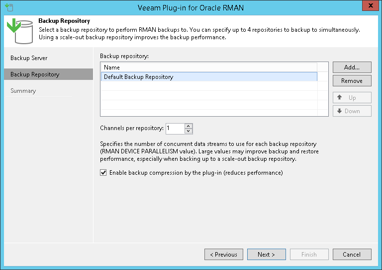

- At the Backup Repository step of the wizard:
- Click Add and select the required repository. For Oracle Database Standard Edition, you can select only one repository. If you want to use the Oracle RMAN Backup Duplexing functionality, you can select up to four repositories. The copies of backups will be sent to all selected repositories.
You must allow access to Veeam backup repositories that you plan to use. Also, the encryption on the repository must be disabled. To learn how to configure access and encryption on repositories, see Access and Encryption Settings on Repositories.
- If you want to use another repository, select the repository from the list and click Remove. Then, you can add another repository
- At the Channels per repository field, specify the number of allowed parallel data streams for each repository.
- Click Next.
Important |
You can work with backups created by Veeam Plug-in only with the account used for creating the backups. If you want to use another account, assign the Veeam Backup Administrator role or Veeam Backup Operator and Veeam Restore Operator roles to the account. To learn how to assign Veeam Backup & Replication roles, see the Roles and Users section of the Veeam Backup & Replication Guide. |

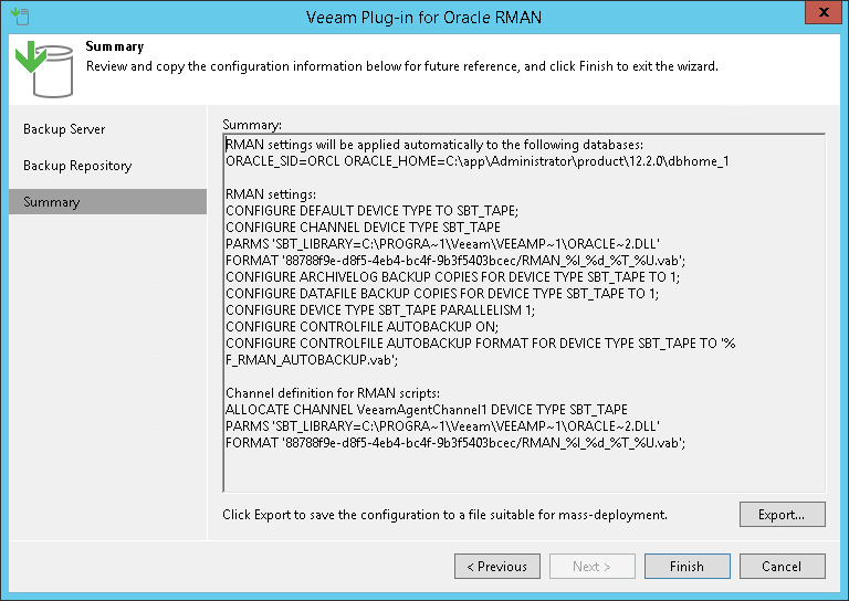

- At the Summary step of the wizard, you can export the plug-in and Oracle RMAN configuration files. You can use the configuration files to apply the plug-in settings on other servers.
- To export the veeam_config.xml file click Export and select Veeam Config.
- Click Finish.
Note |
When you save the plug-in configuration, Veeam Plug-in automatically enables Oracle's Controlfile Autobackup feature. This feature is required for restoring with different settings using Veeam Explorer for Oracle. |
