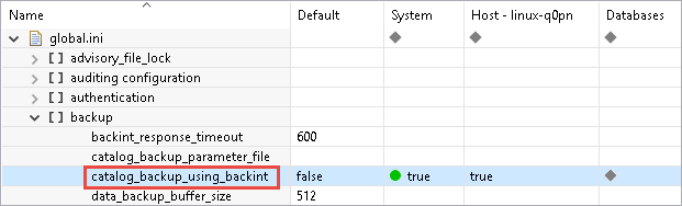

SAP HANA Catalog Backup with Backint
To back up the SAP HANA catalog using Backint, change the settings of the catalog_backup_using_backint parameter in the backup section of the global.ini.
