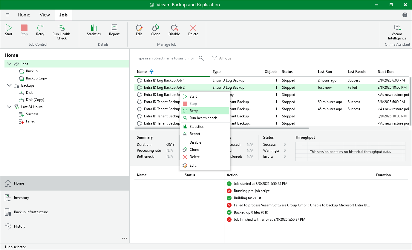

The retry option is necessary if a job fails and you want to retry this operation again. When you perform a retry, Veeam Backup & Replication restarts the operation only for the failed workloads added to the job and does not process workloads that have been processed successfully. As a result, the retry operation takes less time than running the job for all workloads.
To perform retry:
  1. Open the Home view.
  3. In the working area, select the necessary job and click Retry on the ribbon. Alternatively, you can right-click the job and select Retry.
Retry Job
