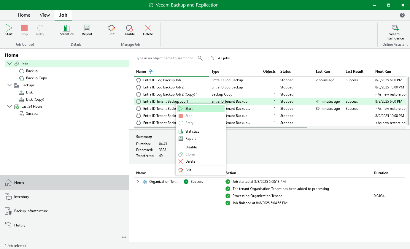

Starting and Stopping Job
To start or stop a backup job, do the following:
  1. Open the Home view.
  3. In the working area, select the necessary job and click Start or Stop on the ribbon. Alternatively, right-click the job and select Start or Stop.
Stop Job
